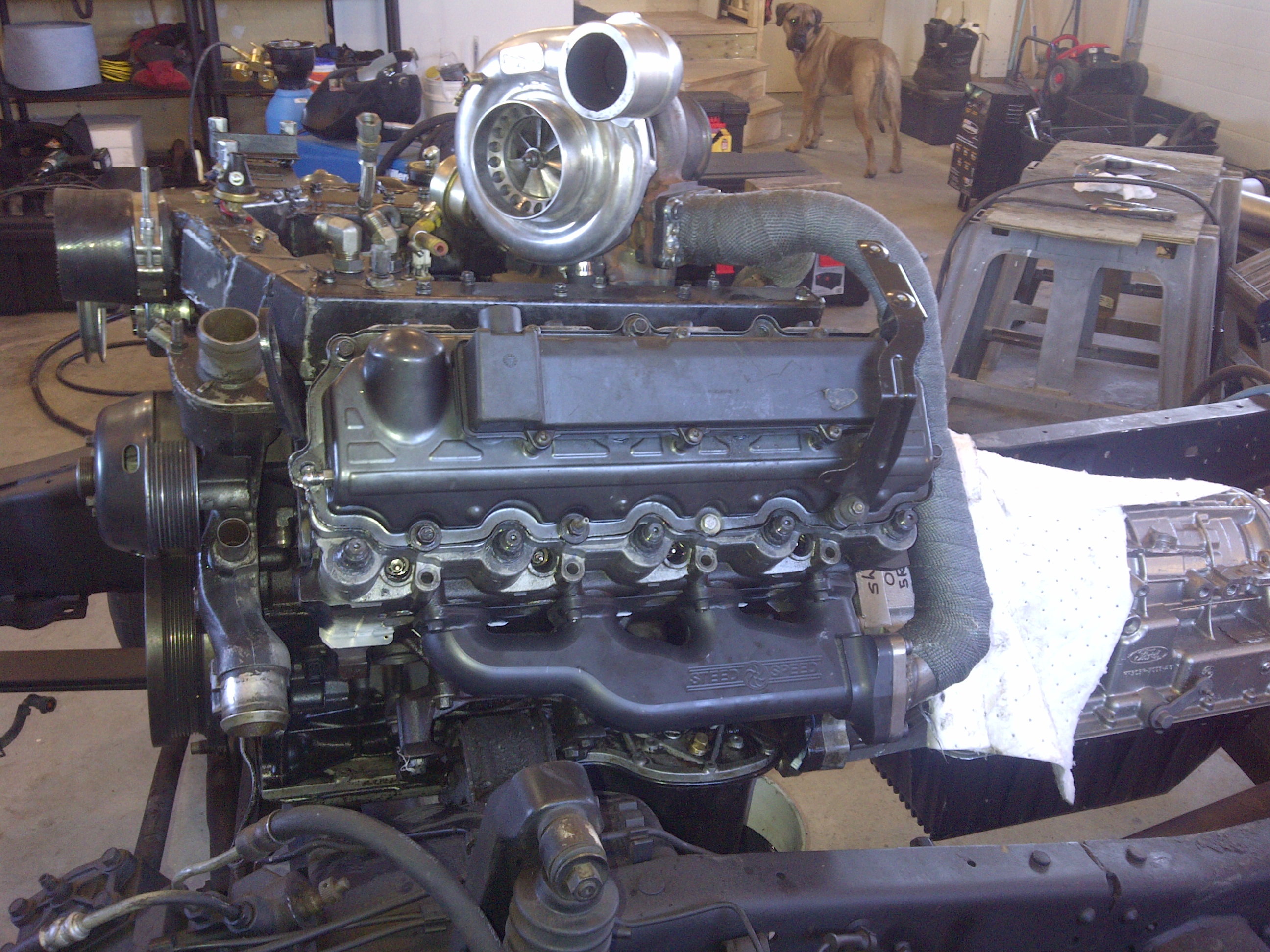

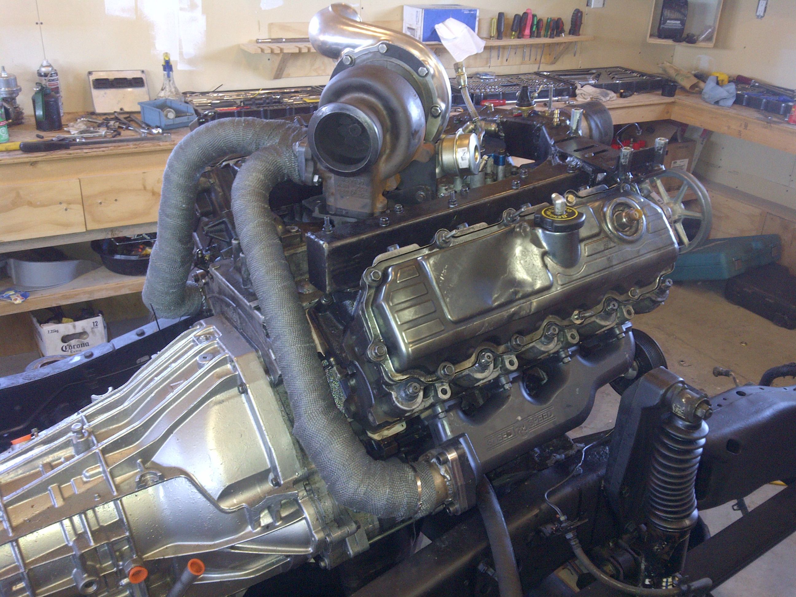

All bolted up. Manifolds fit great, no clearance issues so far. Worst part is having to build new uppipes. I see there's a company in the prcess of building bolt on uppipes for these manifolds. Hopefully they perform as well as they look. Stock manifold exit is 1 7/8. These are 2 1/4. I have them necked back down the 2inch. Didn't know if I'd lose to much in velocity running 2 1/4 all the way

nothing wrong with that, i cant weld to save my life, so I know how i feel the pain. But like said before it works it works, cant seem back there anways.

for them dual oil pumps, loving the intake manifold too :hammer:

I was going to ask, is that his intake manifold?? I see what you are saying Shawn about your welding skills. I bet it flows pretty good though.:thumbsup:

Intake manifold cost a whole $50. Its a piece of 2x3 square tubing. Cut and welded. Built that last year. Yeah it way out flows a stocker

Those exhaust manifold are purdy. I'm anxious to see them tested on a "normal" power level truck. You know, a truck thats NOT putting down 1000+ hp.lol
If anyone is interested, I believe Shawns intake manifold build thread is over on PSN.
Shawn, did you end up reworking that intake a little to get it to lay down flat? IIRC, you had some warping issues after you burned it all together.
