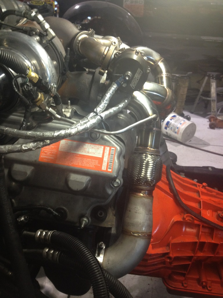

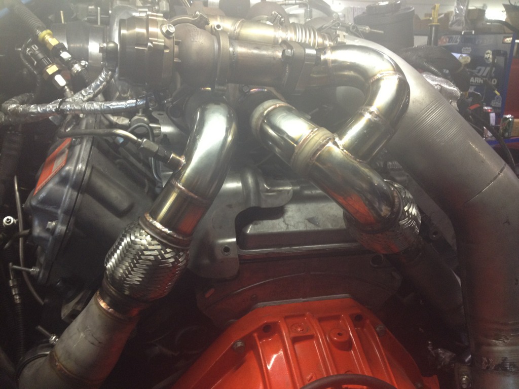

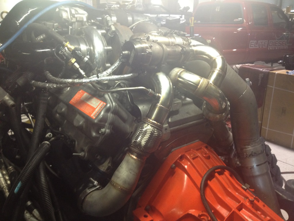

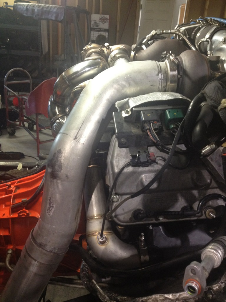

Well once again my wife said ohhhh Mike has some nice pipe! I am beginning to wonder if Mike is the milk man? LoL :D
Just a heads up , did a before and after of steed speed manifolds, the truck went from 743 to 672 ... Huge loss and spoolup as well as back pressure got worse. They will be coming off immediately. Graph to follow when I get to a computer.

Wow, didnt see that coming....

WOW.

Im glad I didnt go with these on my build.
What are you going to put back on the truck Mike? 6.0 manifolds again?
