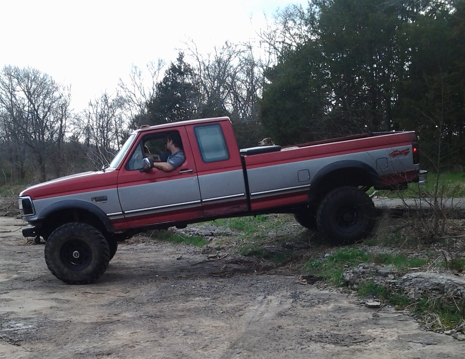

Well anything new going on guys. Boring week around here work work work and no play makes this guy go crazy. I got some pics im gonna post up i guess
StrokerGuy86
Feb 25, 2014
66
Murfreesboro TN
Having a little fun with my buddy before he left for 6 weeks
