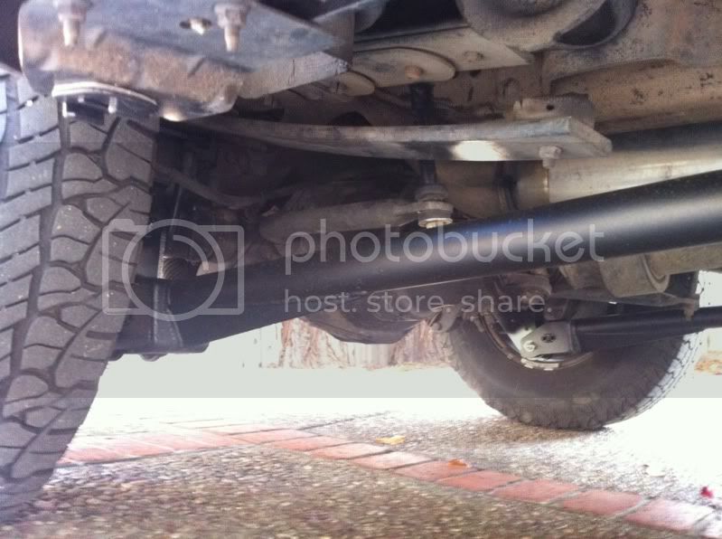

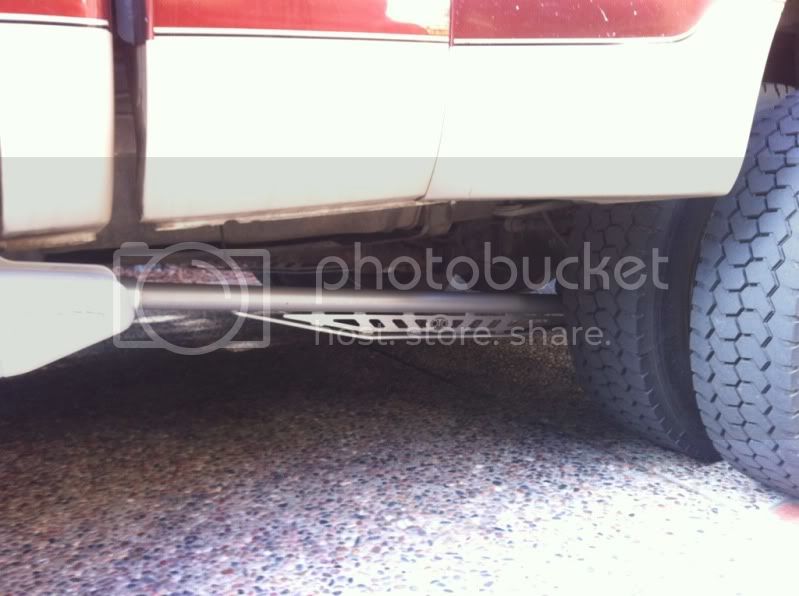

Anyone have a pic comparing the small and large gussets?
Just went out and took some quick pics of the difference between the two I have.
This is the long gusset on my 450
And this is the short gusset on my excursion
