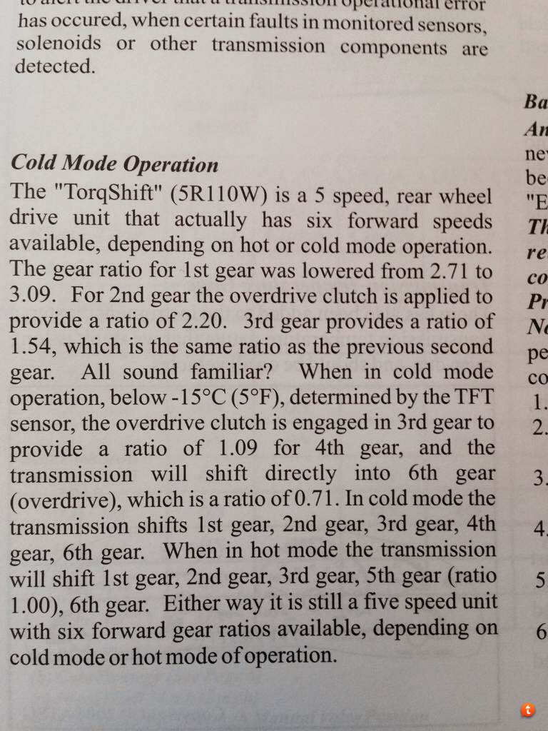

The CTS reads 1-5 so it won't tell you anything... 4 on the cts is actually 5.
Josh@DirtyDiesels
Dec 3, 2011
4,949
PA
Here, straight out of my ATSG manual
