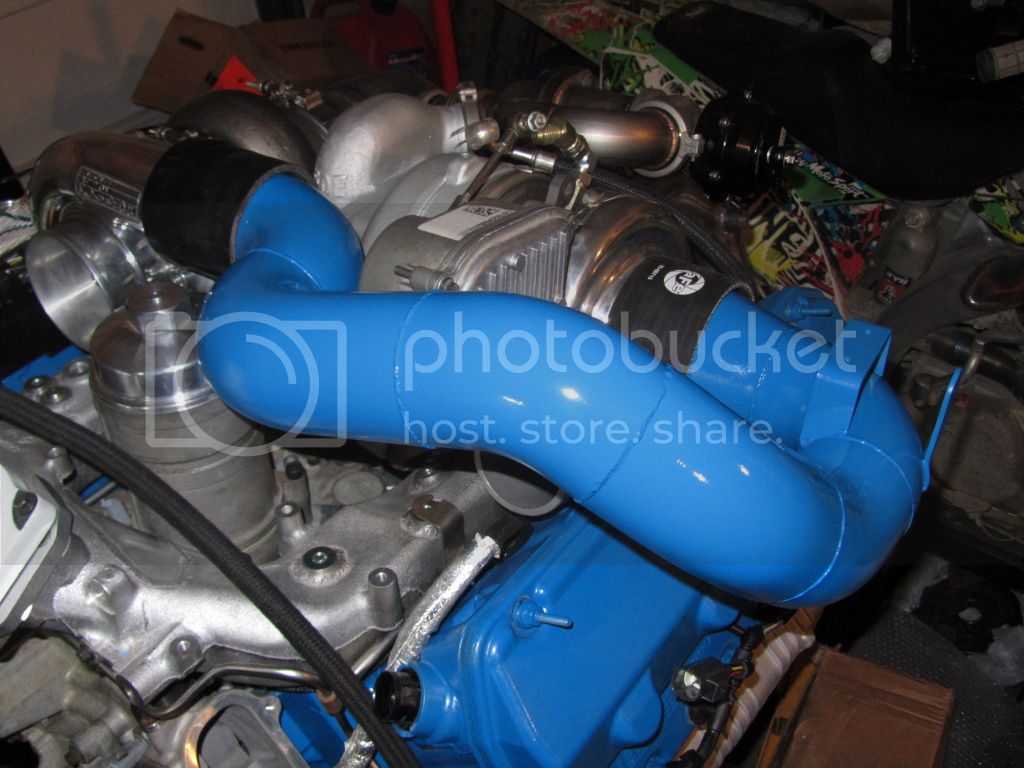

Well it's time for an update. Where to start, haha.
Well I got engaged after I got back from Jamaica, yay me. Had a nice break from everything too.
As far as the build goes...

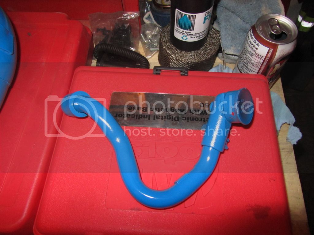

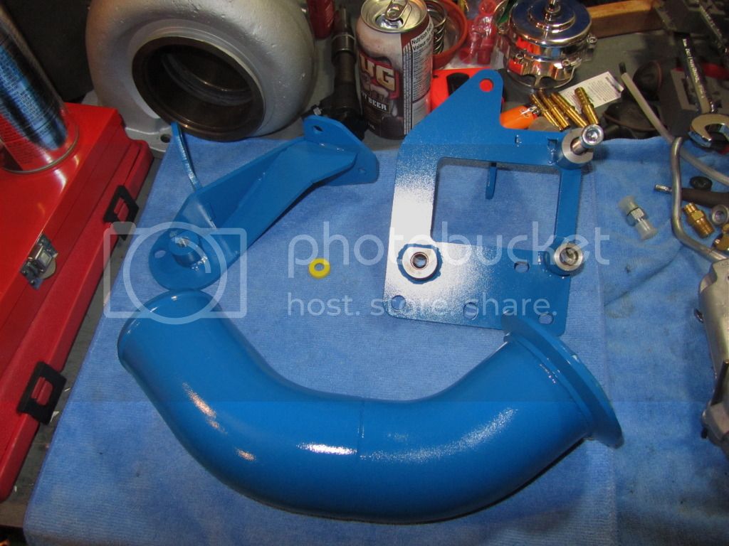

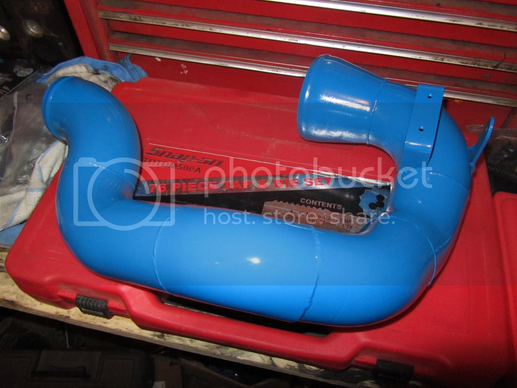

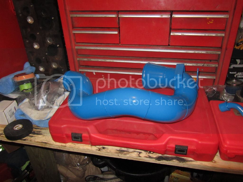

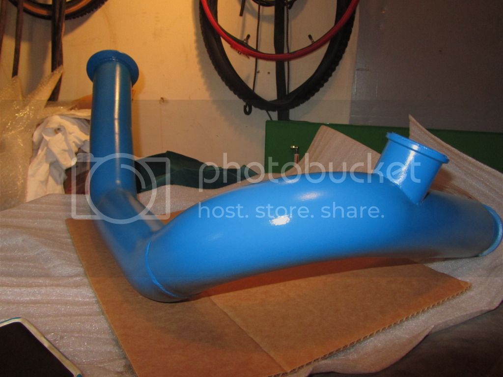

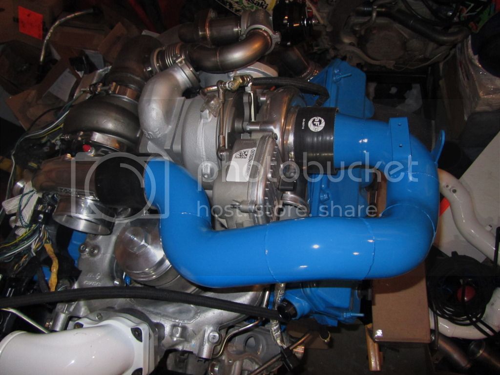

Brakes from Shone are on and they rock. Still waiting on the shocks from Walker Evans, they are waiting on the shock bodies for my application. Did some painting of the charge piping. After photoshopping the colours I ended up going with ford blue. I think it looks great. Going to paint a couple other pieces on the engine but I need to pick up some flat silver paint. I started running the wiring harness, got the drivers side sorted out so you can only see a few wires, now to tackle the passenger side. Heres some pics of the paint work, Oh all the paint is rattle can too.

Looks killer for sure. Nice to see it all coming together. Congratulations on the engagement.
