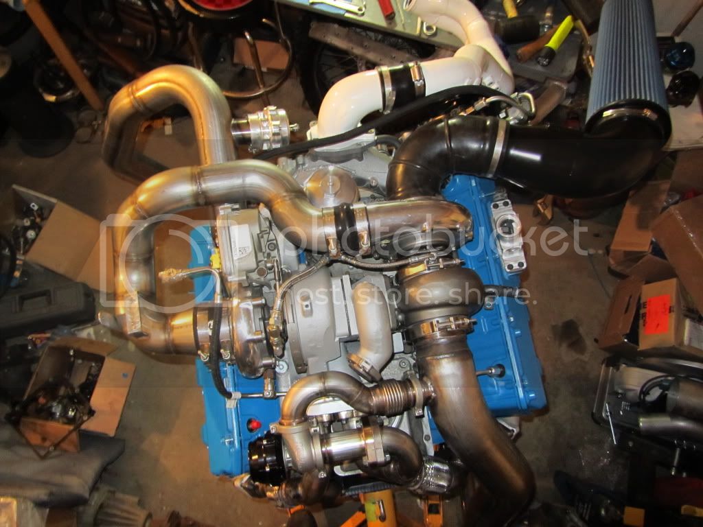

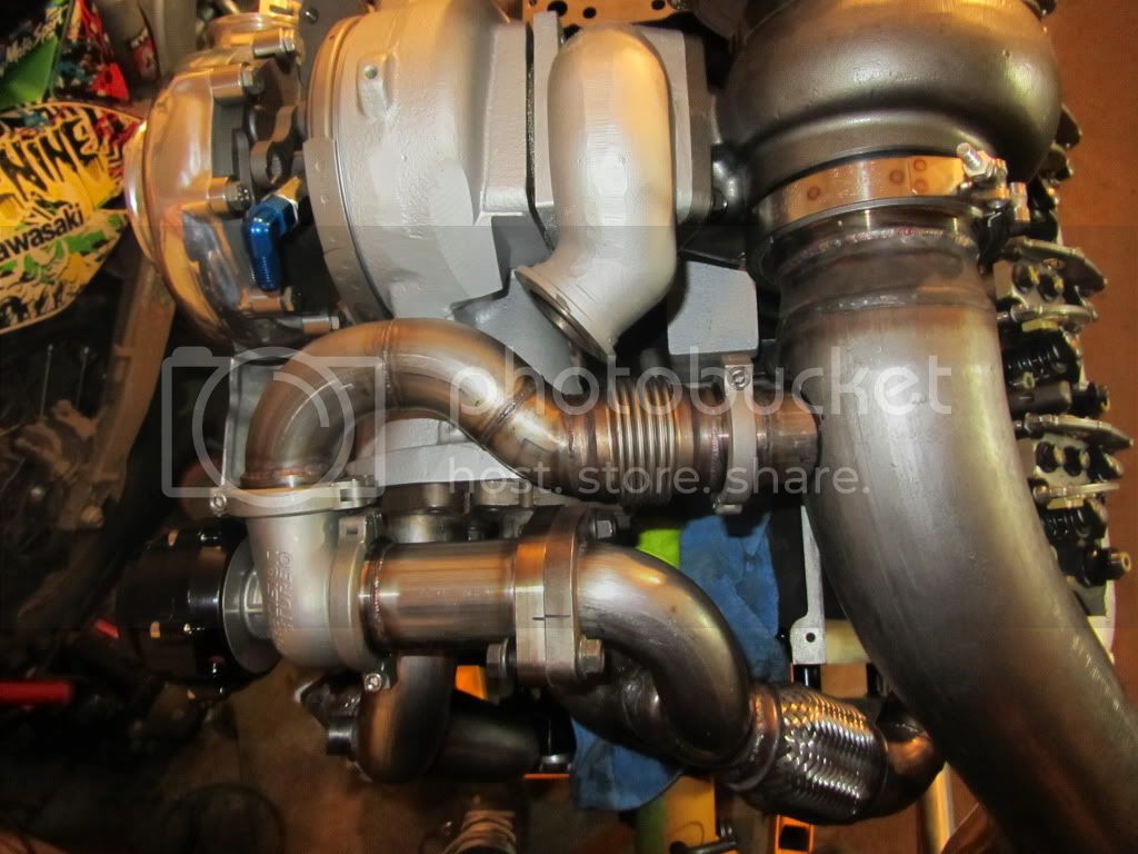

Well I got some time and worked on this beast some more. I got the new upper gate plumbed in, just need to weld the dump pipe into the down pipe. Big Thanks to Tadd and JD at Elite for making this piece for me, Guess Nathaniel welded it up but Thanks to them. With the upper gate not dumping to between the turbos I should be able to spray and run big injectors without having to much exhaust pressures. Here's a pic.
I also mounted up the big exhaust housing and it only needs a bit of modifications, so thats good. next order of business is building clamps for the twin fueler lines. more to come next week, maybe even more paint.
If you dumped the WG into the the larger/Low pressure turbo wouldn't that improve spool up?
It seems if you are running a larger exhaust housing on the low pressure turbo the WG energy could be used to spool that one up sooner.
That's been tried before on another truck with the same housing sizes. Keeping bp in check is hard. Also the turbos light within 5' from a dead idle I'm told. I have the piping to dump between if things don't work thou.

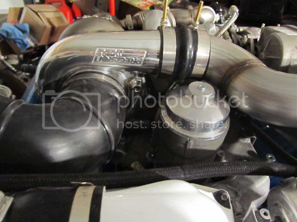

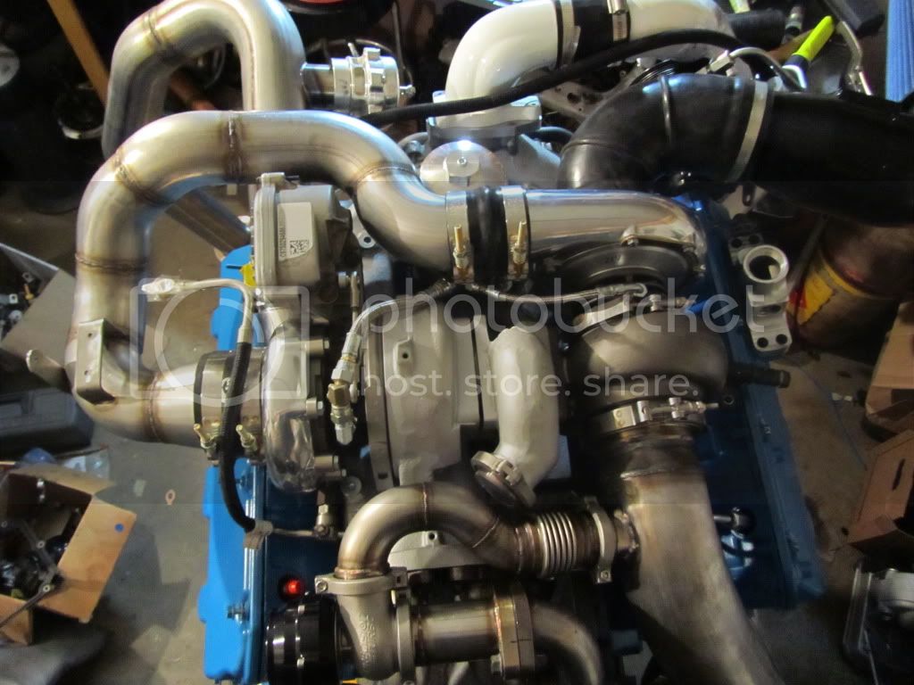

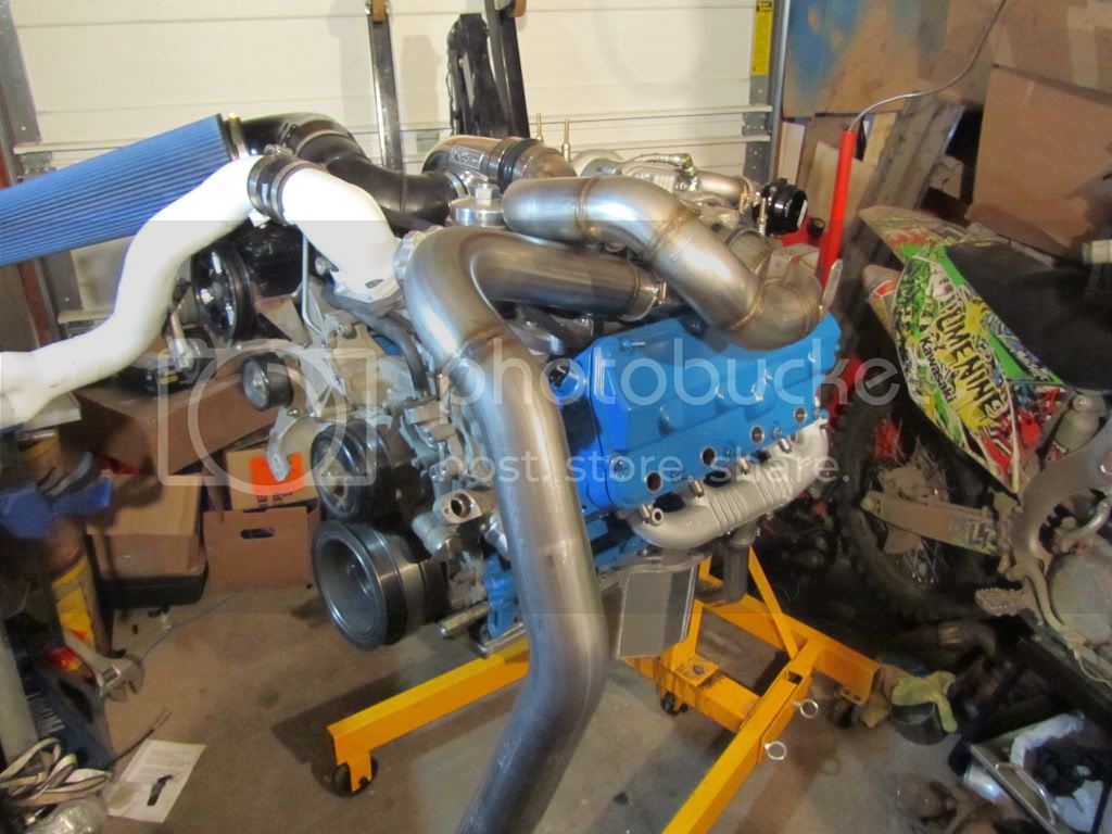

Well the engine is finally built. Small finishing touches are left like clamping lines and getting piping painted. So now it sits on the engine stand till I get time to swap it, could be a long time unfortunety. I also need to get my 4r trans ordered and installed too. But there has been progress on the truck. Installed the RCD 4 link as most of you saw and I picked up a set of SSBC brakes from Shone. Also found 3 blown shocks on my truck so I ordered up a set of Walker Evans 2.0 shocks for my truck. But back to the engine. Intake piping will go out some time in May to be powder coated candy purple and the exhaust piping might go out for ceramic coat but I'm not sure as the coating flakes off after a winter up here so that seems like a useless coating, maybe heat wrap thou. Here's some pictures thou.
Be a couple months till I get my 4r. Got to finish up some intakes for ppl and do Pog's build in July. Also next month I'm gonna ask my girl the big question so trucks getting pushed a side for a bit. Enjoy the pics guys.

If anything coat the insides of the exhaust pipe in a turbine coating or something similar. Works great on my hot pipe and you could just leave the outside raw metal i'm not much of a fan of header wrap after using that stuff on my hot pipe inside and out. Could amost set your hand on it after a pass down the track
