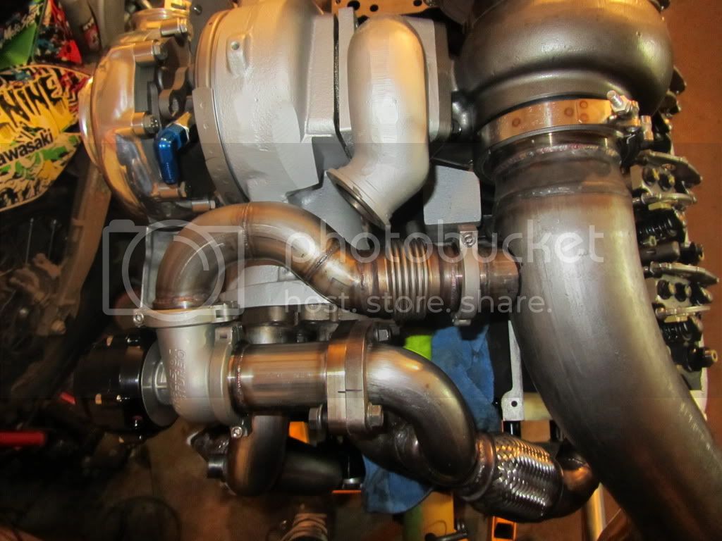

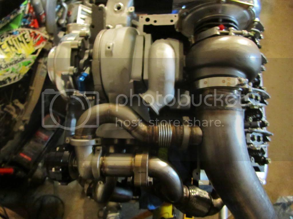

Well I got some time and worked on this beast some more. I got the new upper gate plumbed in, just need to weld the dump pipe into the down pipe. Big Thanks to Tadd and JD at Elite for making this piece for me, Guess Nathaniel welded it up but Thanks to them. With the upper gate not dumping to between the turbos I should be able to spray and run big injectors without having to much exhaust pressures. Here's a pic.
I also mounted up the big exhaust housing and it only needs a bit of modifications, so thats good. next order of business is building clamps for the twin fueler lines. more to come next week, maybe even more paint.

Kinda what I figured, it was hard to tell for sure in a two-dimensional picture of a part I've never seen in person haha.

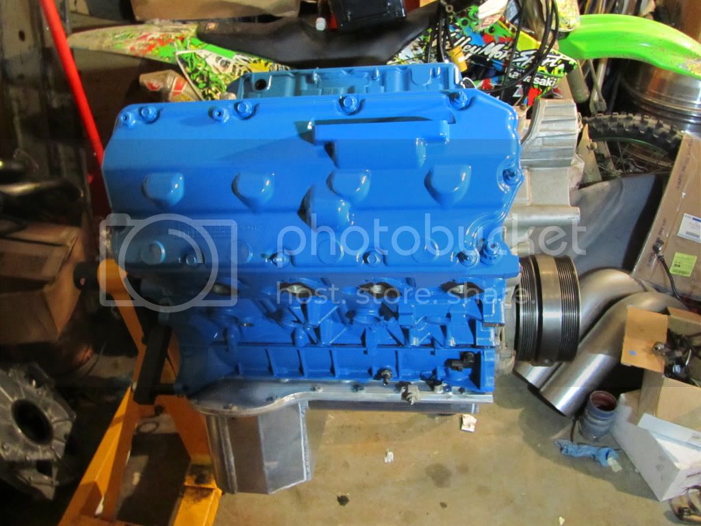

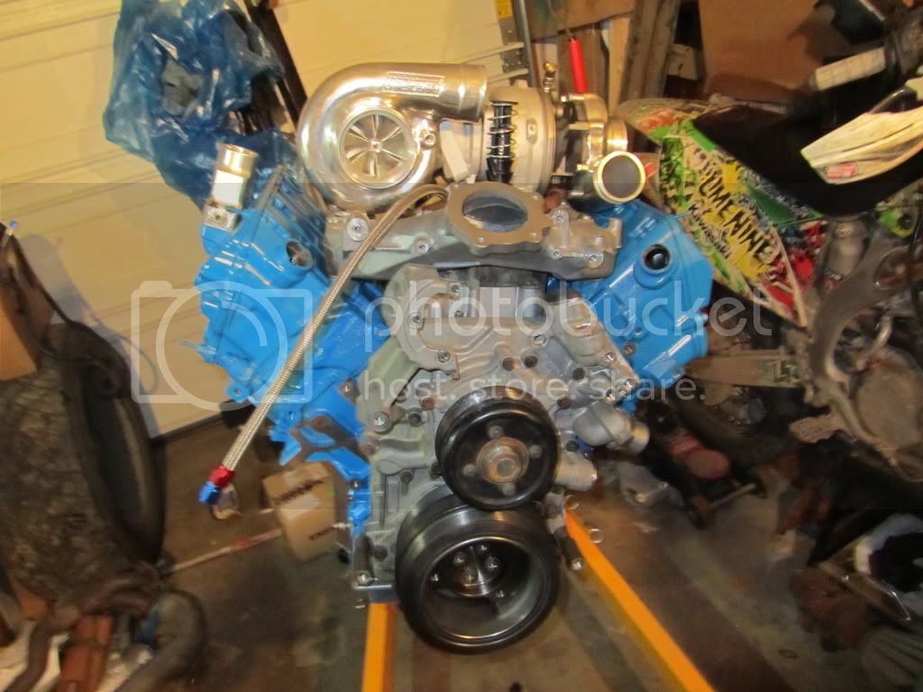

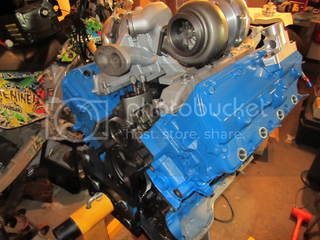

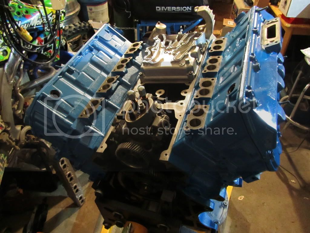

Well short blocks done other than fuel rails and injectors. All that's left is the rear cover and flex plate. Twin fueler lines also need to be clamped down somehow. Here's some pics.
Also should have my RCD 4 link kit on Tuesday or Wednesday and hopefully get it in before my days off ends. Once it's in I get to find new shocks again, damn ranchos blew just like my bilsteins did. Any suggestions? Enjoy the pics.
