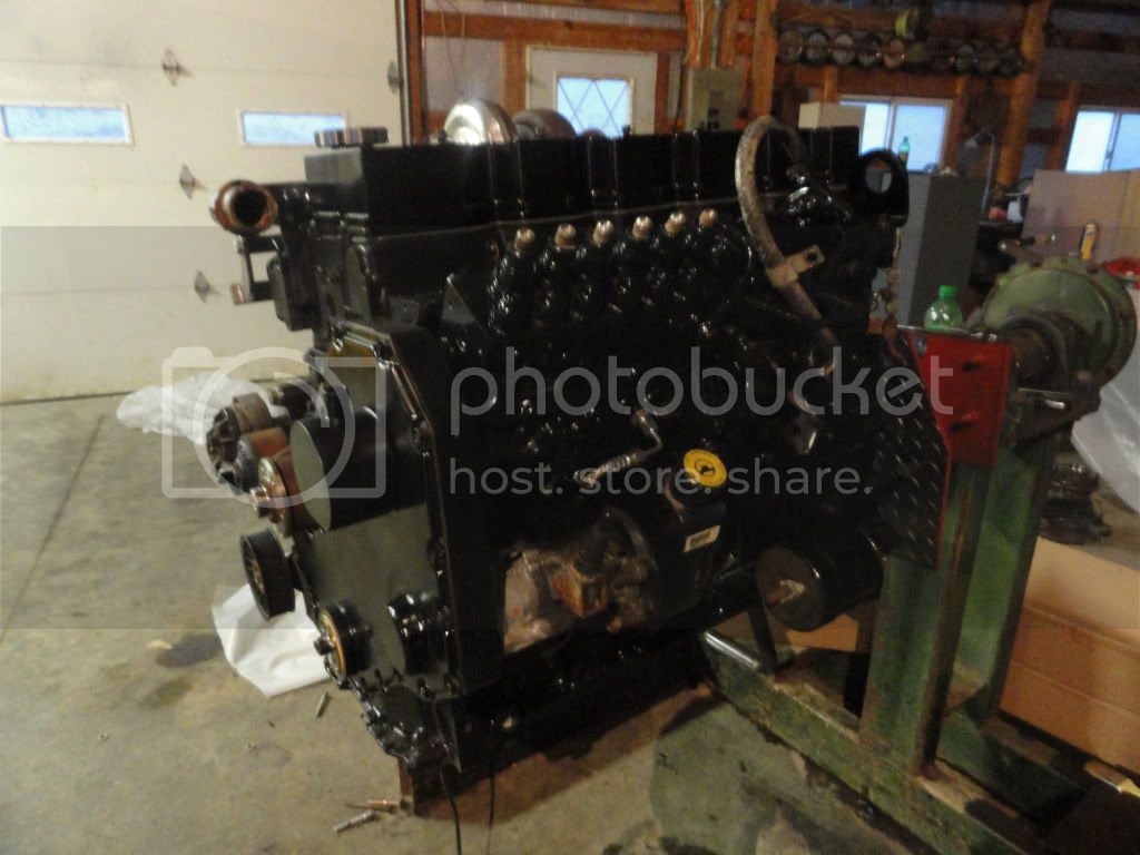

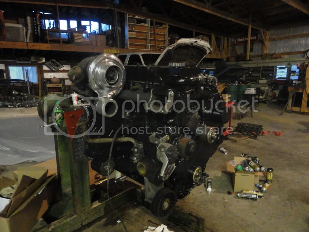

Thanks! Yeah Ill have it set up just how I want it and Ill know whats gone into it so thats the best option in my opinon!
I worked a little more on the engine today, got the pump mocked up on the engine and got the mount where it needs to be and figured out the oil feed line and got a 4an stainless line made for it.
Also mocked up the turbo and manifold to see how the stock feed and return lines will have to be modified.
Here are two quick pics:

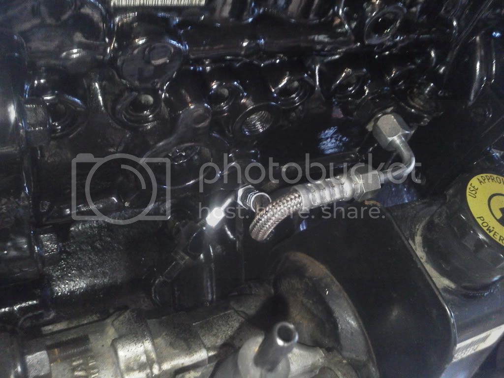

Getting closer, pump is getting timed tomorrow. And also a close up picture of the oil feed line I got made for the p pump

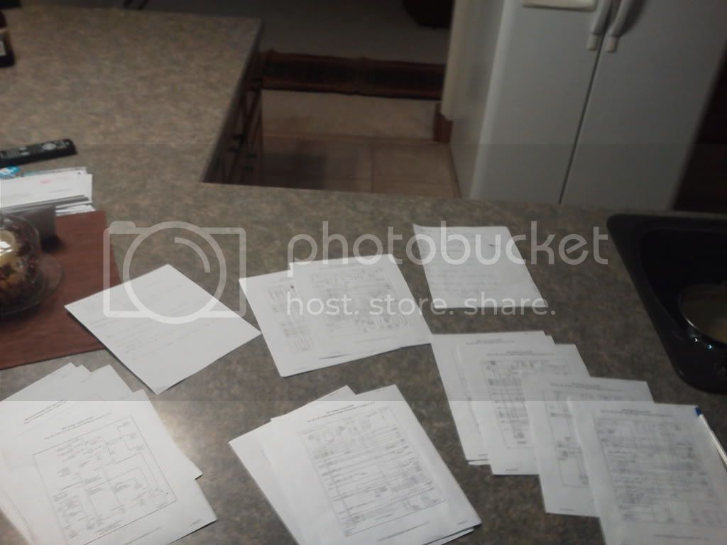

Worked for a while this weekend on figuring out my wiring for the tranny with the dodge PCM as well.

Well i watched my trans get built yesterday, but didnt do any work on the engine today, instead I worked on the fun part of the swap

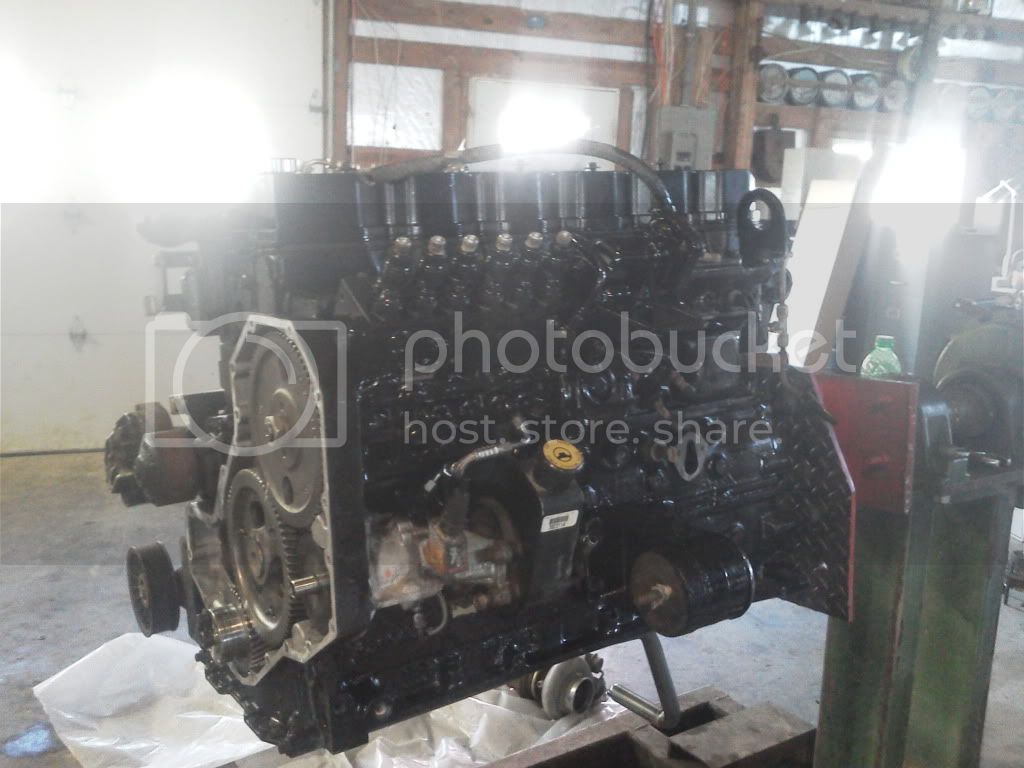

Engine is pretty much finished besides pulling it off the stand to put the rear main on and oil pan. Couple other small details left as well. Now I just gotta wait on my destroked mounts to get here to put the engine in.
Big thanks to Jason and Bryan as well for fixing my valve cover and polishing it up real nice. Today I got the turbo all polished up too.
