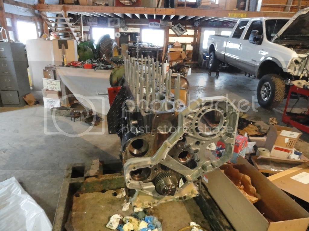

Got some progress made today, ignore the ugly engine, Ill do some painting tomorrow. Got the head on though as well as the front cover, tappets, cam, intake manifold, oil cooler and water pump. My cam endplay was in spec as well.
When I got home tonight my new injectors and p pump were sitting here as well so I got plenty more to do tomorrow. Here are some pics:

it was hot tanked twice all the stuff still wouldnt come off then they spent a long time on it with a wire wheel on the grinder.
If you have it sand blasted i would be careful not to get any of the deck or anything were its supposed to be smooth.

Thats no fun. How did you guys prep the block. Im thinking of sand blasting mine, but trying to keep most of the motor blocked up so the sand doesnt get every where in side the block.
Like bryan said hot tanked twice then lots of work with a wire wheel. I wouldnt sand blast your block, no matter how much you cover stuff up your gonna get sand inside that block and your not gonna be able to get it all out til its eating up your bearings. I would either get it hot tanked somewhere or find a place that can bake it to take all the **** off. I would steer away from glass beading or sand blasting the block.

Thanks matt. I know someone who did that to a small block, so far its not having any problems. But i would rather be safe than sorry. How much was it to hot tank it.

No probem, Id just play it safe if I were you. The hot tanking was included with all the work that was done at the machine shop since it had to be hot tanked to remove all grease and oil prior to machining. I would just go to a local machine shop and see if they will stick it in the hot tank for a day for you.
Also I didnt have much time to work in the shop today, only about 3 hours so I didnt get a whole lot done, but I got the injectors and valvetrain in, tappet cover, and some of the accessories. As of right now Im getting extremely frustrated with these alternator adapter brackets as nothing is fitting the way it should at all. Anyways here is a couple pictures:
