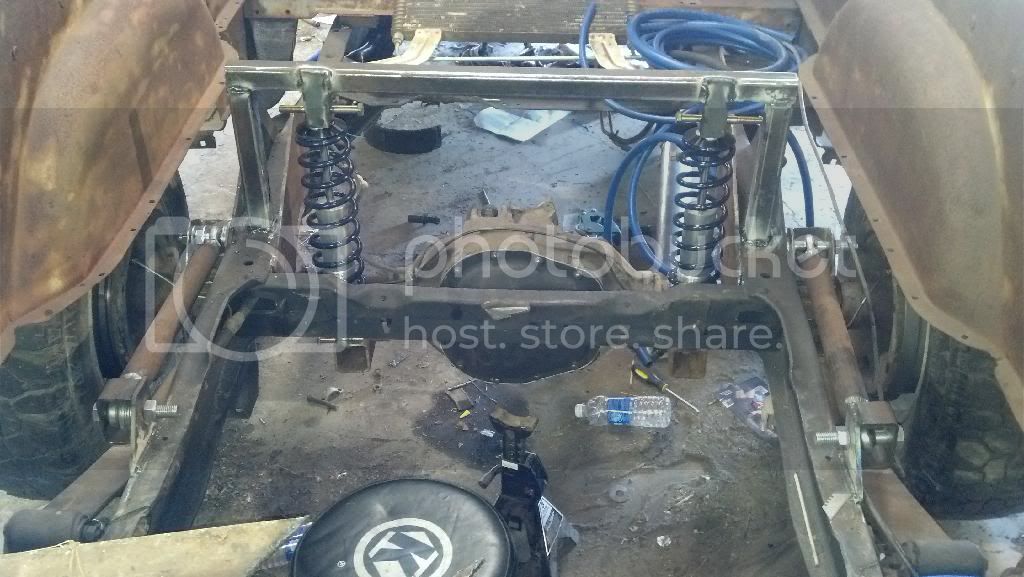

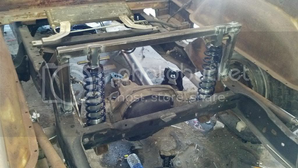

I like how the suspension turned out looks good. Hopefully it hooks up real good too!

I do too. Technically it's still a stock leaf spring suspension. I just removed the stock shocks and some leaves and added adjustable coil covers. Then I technically just added a trac bar.

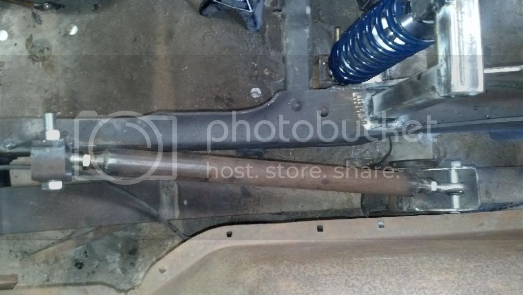

I must admit I am a bit perplexed by your suspension and chassis setup. I get why you stripped it down to a monoleaf and used the coil overs to actually control the spring rate and dampening forces of the suspension. I get the need for the additional bars to control the axle - BUT - the way you have it setup will actually bind your monoleaf setup since you have it on the shackle side of the spring - if you were to reverse the mounting so those bars go forward you would be able to better mimic a 4 link in geometry and setup, allow free motion of the suspension, put the bar in tension instead of compression, as well as many other setup improvements all by switching those bars around.

Already got that covered. I have two choices. Both of which are setting here and all I need to do is bolt them on. The first is a half leaf that goes from the axle forward and clamped tight at both ends and the middle. Basically turning the leaf itself into a rigid trac bar. The second option is a second set of bars on the bottom of the axle also going rearward. I have already welded the brackets and built the bars. They're just not on there. I haven't installed them yet because I don't have confirmation as to whether or not it will disqualify me having a "4 Link". 5 minutes though and both ways of doing it are installed. The biggest reason for the reverse traction bar set up is so that the force of the axle wrapping is directed to the rear transferring more weight over the rear tires. They are also set to go from perfectly level at full compression to angled upward to the rear so that the force of the wrapping actually lifts the rear causing the wheels to be pushed down even harder giving better traction. It's all theoretical brainstorming between a couple guys who don't know what they're doing, so who actually knows. LOL

You can accomplish the same thing with a forward mounting bar with less geometry issues and better control. This is the same thing us pullers have been doing for a very long time.
