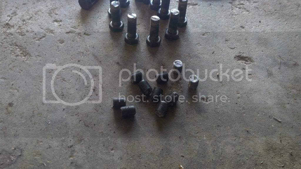

Ready to go back together!
vanderchevy18
May 19, 2011
2,024
Benton, Ks.
New bolts are in. Only problem is the locating pin isn't. Should be fine though. Gonna slide the transmission back up tomorrow and go racing Saturday!

Not exactly a broken flex plate.... But yeah. They'll definitely make you think you have big problems. I thought for sure I grenaded a piston. Of course I haven't started it up yet so I don't know for sure. LOL Sad part is I should have known better. This isn't the first time a flex plate has made me think the worst.

bigrpowr
<How I Fly
Administrator
15,240
dang i made 799 corrected in a 7.3 back in 08' and never broke those bolts , musta had some crazy torque #'s !!!
vanderchevy18
May 19, 2011
2,024
Benton, Ks.
I'm gonna attribute it to loose bolts or they were overtorqued some time in the past. They were torqued to spec (89 ft lbs) by me and where they sheared they were still fully seated, but it has to be one of them. I know there's guys making more power than me that haven't had this happen to them. But in my mind I like to think I was putting out some record torque numbers though. ;) LOL

Part that threw me was the truck would still start.
Line up nipple musta held for a lil while then...
Vander, when you tq'ed the bolts did you remove and loctite them or just a tq check and left them installed? Where all the bolts sheered at the same spot?
