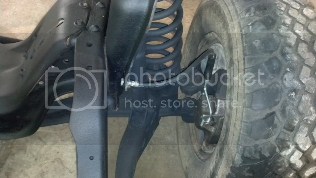

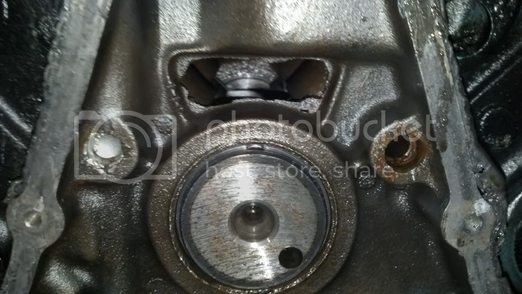

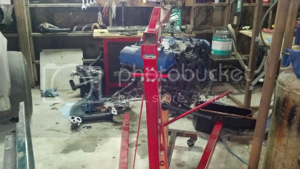

Well I've been so busy that I haven't been able to work on it. I finally had some time Christmas eve. I got the front brake system and bearings all replaced, cleaned and painted the chassis, and got the motor pulled apart. I need a new freeze plug for the oil gally at the back of the motor. That's where my oil pressure went.
cfdeng7
1,369
CT
I would tap those oil galleys and use a npt plug. Never have to worry about blowing a plug again

vanderchevy18
May 19, 2011
2,024
Benton, Ks.
I just plugged them. If it blows out again I'll go ahead and tap them.

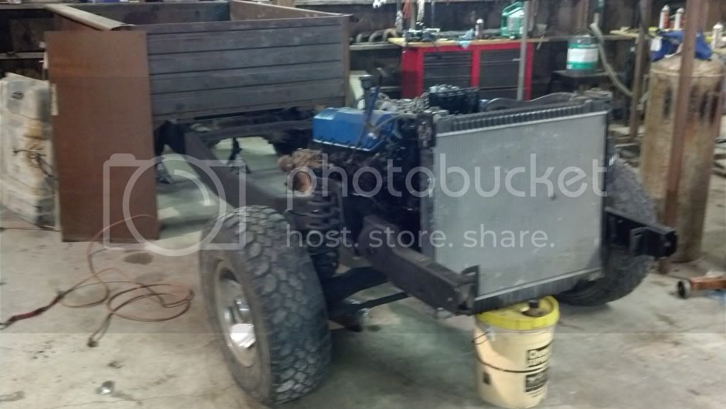

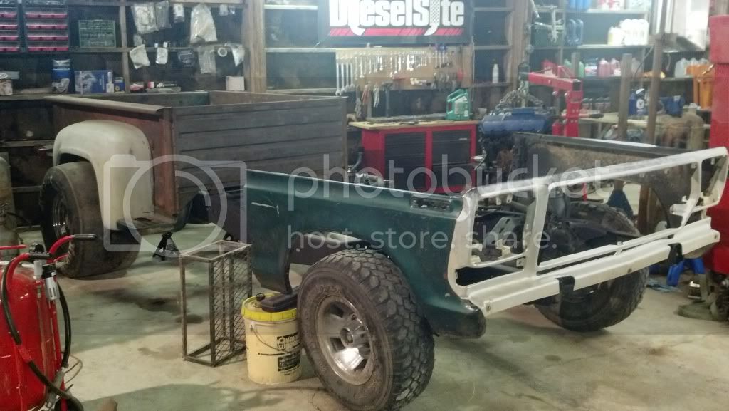

I have the engine and a mock up trans in. Now to get the cab on to get the mounting brackets welded on and finish putting in the wiring.
What do you guys think about the radiator? Leave it up front or put it in the back?

I also seal welded the oil pickup tube and put new seals in the high pressure oil resivour. I'll be getting a Dieselsite reivour spacer later.
Chvyrkr
2,205
What's your plans for IC?
I'd leave the rad where it is unless I ran into issues fitting an IC.
Cutting-Edge Diesel
Feb 10, 2012
5,738
Newkirk, OK
is this going to be a pure drag truck? reason i ask is that is a big radiator lol. I have a tiny one in the ranger and dont have a problem with it getting hot at all. saves weight to have a smaller cooler and less coolant.
vanderchevy18
May 19, 2011
2,024
Benton, Ks.
Matt I was actually thinking about picking up a small one from somewhere. Something maybe 2-3" thick, 12"-14" tall and 24" wide. Little guy. If not, at least my flexalite fans will fit this one.
Also, for intercoolers I thought about looking for a couple tiny inline coolers. It's hard to explain what I'm looking for, but something I can use inline from the compressor outlets straight over to the intake plenums.
