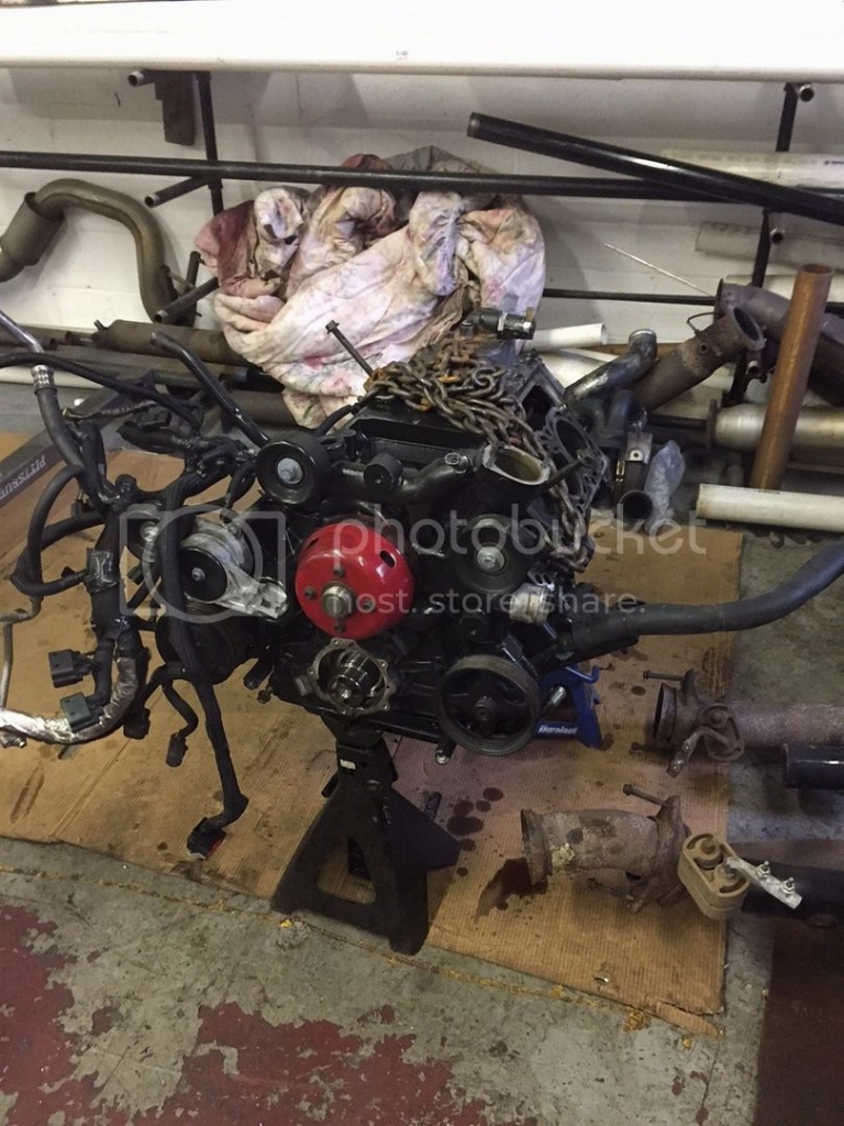

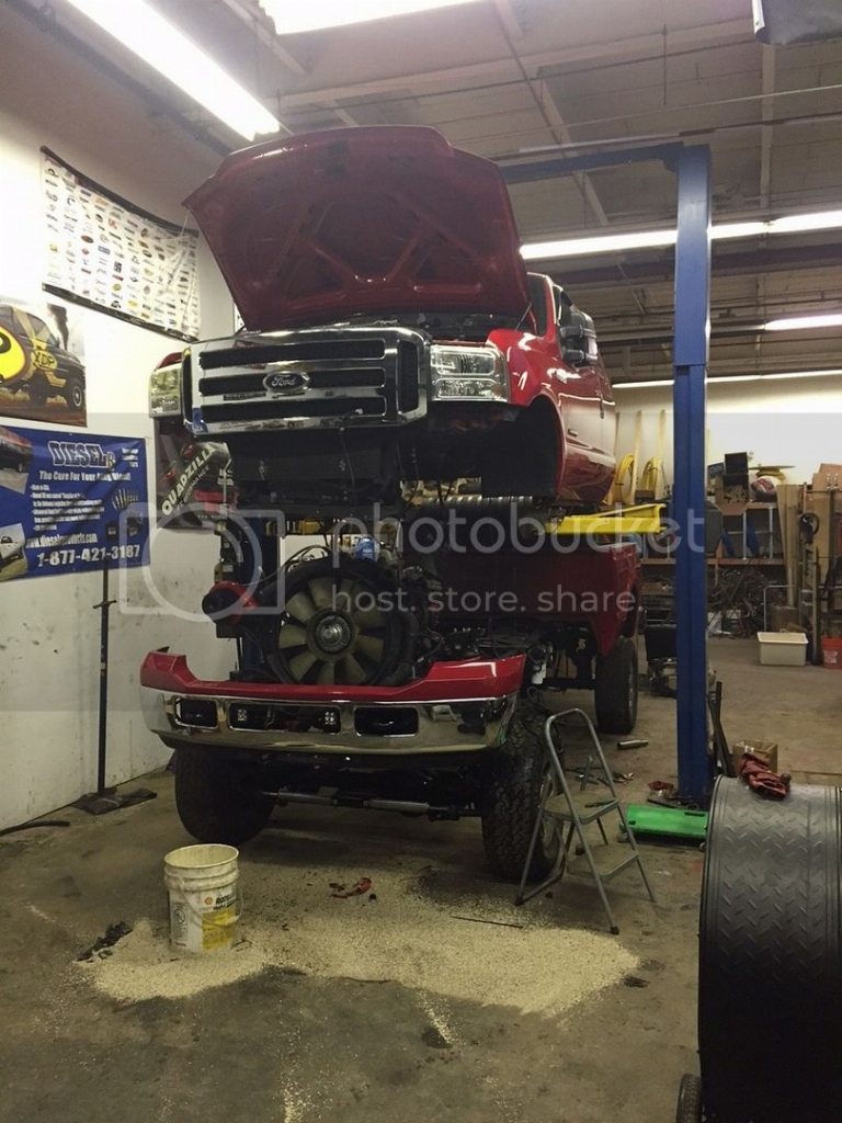

some more progress last night.......
weekend the shop will be closed....hoping next week to have the motor out and torn down, maybe get a first look at the damage.....

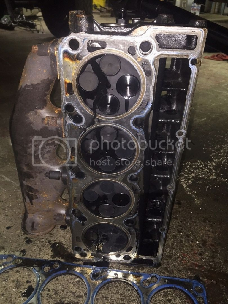

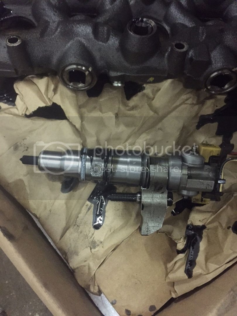

got the heads off:
extremely happy and surprised that the heads were hardly touched, just had some piston/valve contact, but nothing serious, heads are reusable, as well as the injectors

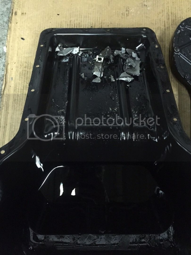

Then we find this:
waiting on the machine shop do finish the block, then well assemble everything....in the mean time, injectors will be headed out to MFI for a refresh, and scrap block will be pulled out of the frame rails.

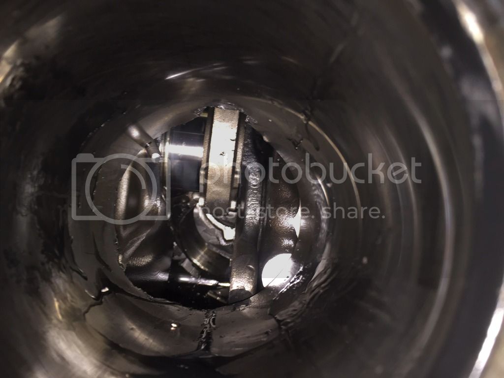

well.....got a real good look Friday night at the damage...
Block lasted 66k. after the trucks back together and I have some spare time, im sure il take this apart to get a look at the inside, but right now...aint nobody got time for that
