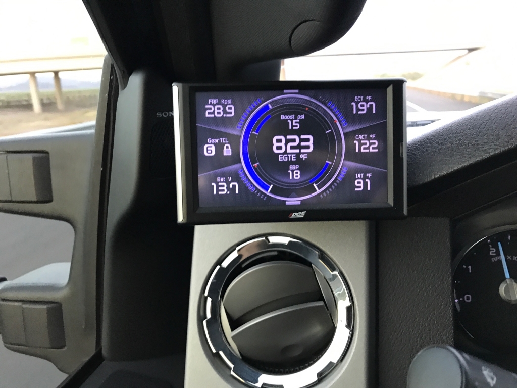

So, this is towing 5,500 lbs at 85mph. The delta was 30degrees, not bad IMO, this new Intercooler seems to be working great.

Back on topic, if I understood right, you were saying that your CACT was getting to 200degrees with the NL intercooler?
Are you able to monitor IAT and CACT and provide the delta?
If your temps are really that high, have you checked to make sure there's enough Coolant in the secondary system?

That's cool egts also. I know off topic. My cac temps are the same as yours but my egts are around 700 driving empty at that speed. Seems hugh compared to yours?
That's 823, and it looks like Jomax is in it a bit since it's showing 15psi of boost.
My truck has stock tires and no lift. I'm sure that helps egts. But the truck does run cool.
