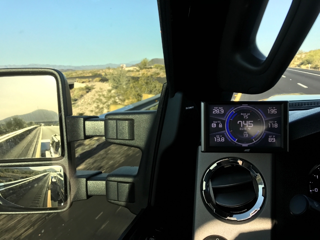

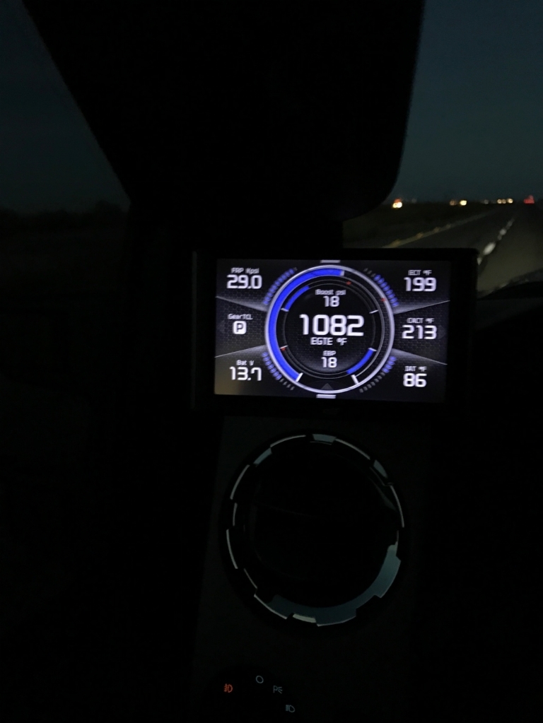

Temps before
After
Also brought the truck to well past what the speedo shows and zero puking.
Trucks seems to run better ever since it had a gallon of coolant go through the intake LOL.
