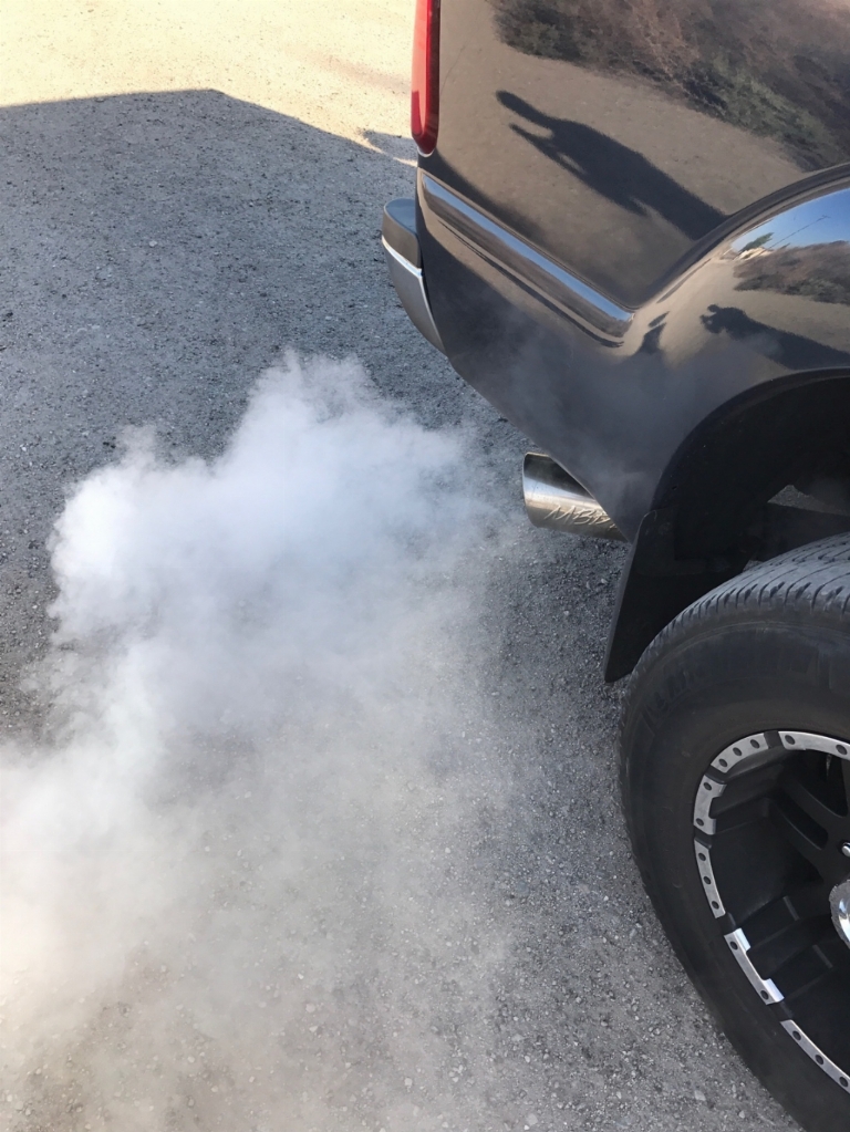

well, the radiator leaked for about a year so I was putting in about a gallon every 6 weeks then I just had the radiator replaced before Christmas with all new coolant. it is seeping out from behind the pully.How often have you been changing the coolant?
lucky.. im in new york and everywhere said they have to hook it to id's and do the ****in emissions update by law.. so I can't even get it to a dealer with 95k on it..
where exactly does it puke from?Installed No limits EGR pass thru plate and it didn't help. Still pukes, I have a good CAC coming by this weekend. Will update if it fixes it.
how the *** does it make it clear over there? how hot does the secondary coolant get?Secondary overflow hose.
oh wow.. makes senseI have a catch can and i routed the breathing tube to the top of he motor, never thought I'd fill it up.. whole motor had coolant lol.
From reading the secondary coolant temp sensor, it gets to 123degrees?
oh sweet! good luck man!... prolly should get a no limit ic rounded up for the next time..Changing the oil for good measure and she's good to go. These things are tanks. Way I see it, it had free water injection for a bit. Lol.
Got a IC from sportschassis on here off his 2016. Just installed it and all seems well. I leave for CA in the morning, will post my results.
