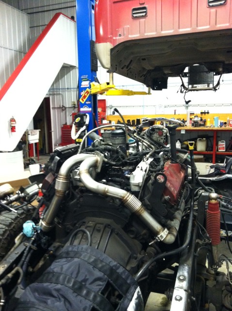

anybody want to post up some good rear shots of divided up pipes? I have a good plan but always open to options
