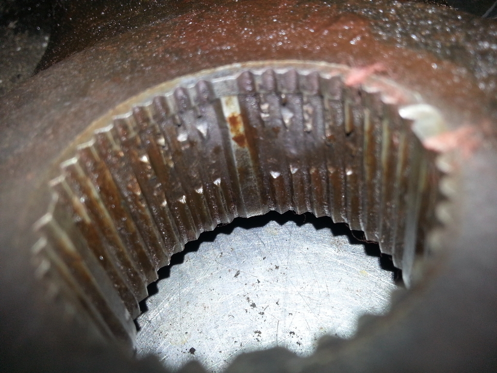

Got er done tonight. I started to loosen the line from Hydro to box and it started to twist. Luckily parts store brought a line right over.
The drag link came off Ok, I left the nut on a bit and hit it pretty hard with a mini sledge, didn't budge. I put the puller on and when I tightened the arms down or dropped right out.
Pitman arm literally fell off with box on the bench. The splines were completely FUBAR.
With the new pitman I had to adjust the drag several turns. I went too far now and wheel is a rad to the left.
But this thing steers amazing now.

I think the shaft splines were ok, just pitman chewed up. I'll check when I get to work monday

Lol. You tell me man.... The output is fine, no marks at all...

I've seen a realize that and they all had loose nuts. Not sure how it happens though. You'd think the edges would get tore up before the middle. The output shaft is a harder metal than the pitman arm that's why the shaft isn't damaged.

Even with a loose nut. As hard as it is to get the pitman arm off I wouldn't think it would mess the splines up on either the shaft or the arm
