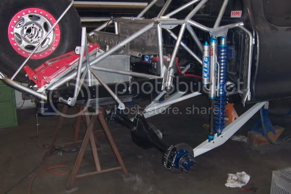

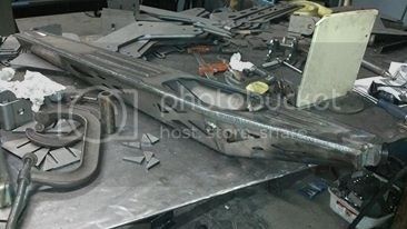

Should get the bender tomorrow.
Next on the list of things to do is get some 2'' DOM and get the bed cage built so I can mount the rear bedsides.
Then Im going to go right into making my rear suspension.
narrowed it down to a couple options.
option 1. single triangulated 4 link.
Good thing about this set up is it will be strong. and I will be able to use my existing mounts for my old traction bars.
cons is it will have rear steer with extreme articulation
fix for this would be to run a rear mounted sway bar and limit the articulation in the back.
this would be like a trophy truck set up
other options is a wishbone 3 link.
pretty sure im leaning towards the single triangulated 4 link.

4 link. How fast will you really be going with it articulated enough to rear steer? Trophy trucks run it for a reason.

Oh it would be a crawling scenario when it would effect it. But I think I can live with it.
