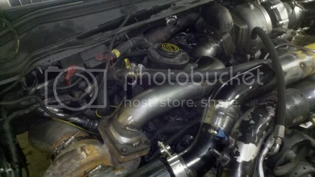

Thanks tomorrow and Friday I hope to have the welding and fabrication done so I can ship everything off to be coated

the down pipe looks sweet in the wheel well like that! will it hit the cab or the frame when the engine moves?

Make sure there's enough room between the exhaust and the frame/body, otherwise under power you'll get a nasty vibration when the engine flexes over and things start getting together.
Looks like you've about got that thing licked.

I have everything spaced pretty well there is 3/4 inch between the frame and down pipe and a little less between the cab but the way the engine torques it should hit the frame first. It may take some tweaking to get it perfect but I'm satisfied with the clearance at the moment

Cool. I just wanted to throw that out there. I know I sometimes get all "zoomed in" on one part of something and forget about other aspects. Relative movement is a common one to bite you in the ass if you lose focus on the bigger picture for a second.
Looks pretty good man.

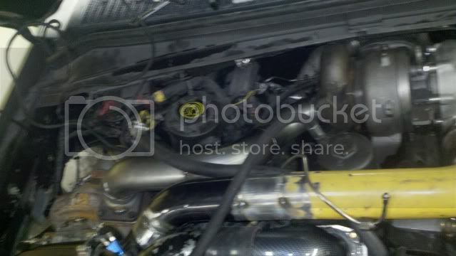

For tonight i got the hot pipe fab'd up, took forever to make the flang ends work, what a pain, anyway here it is, got lots of clean up work to do no doubt
I also learned the proper way to sharpen lawn mower blades LOL
