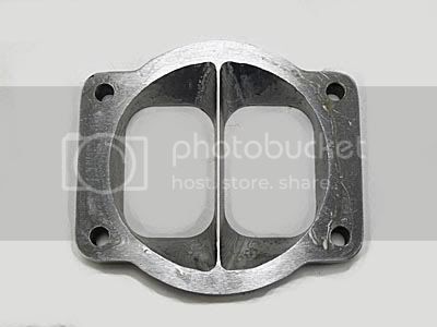

Engineered diesel makes a 3.5" to t6 adapter that is slicker than ****, and it doesn't have to oval or anything.
I checked out their site and no flange but some very usefull wastegate systems.

Is the Kind of flange you are talking About???

No this one is for a goes from a 4 inch pipe and goes to a T6 Flange. So there is no need to flatten the pipe to make it fit.
