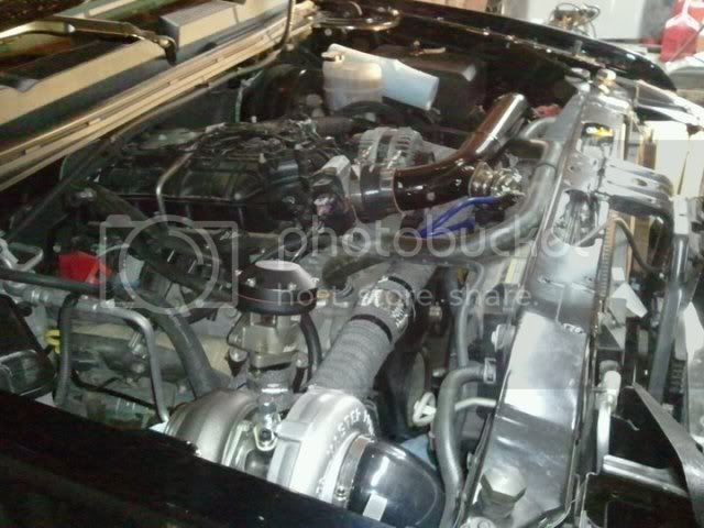

my buddy has a turbo'd 5.3, ill see if i can find some pictures, its legit.

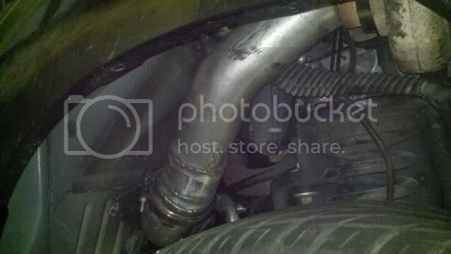

Got the down pipe done tonight. more work thursday night and possibly friday need to get the hot pipe done asap and shipped off to have coated

I like that clamp there... thatll make for easy removal
The bottom half of the down pipe barely fits, i mean barely, but it goes in, and i think now that its set i dont need to remove the bottom half ever again, the top half comes out easy its awesome.
The top half is already ceramic coated since its most of a Powerstroker67 pipe anyway so im leaving it, and protecting the rest of the stuff from the heat.
Here is the pic of my buddies 5.3, its a 2010 truck, i think one of the first with a turbo, tuning has proved to be a biach, also needs a rear driveshaft upgrade.
