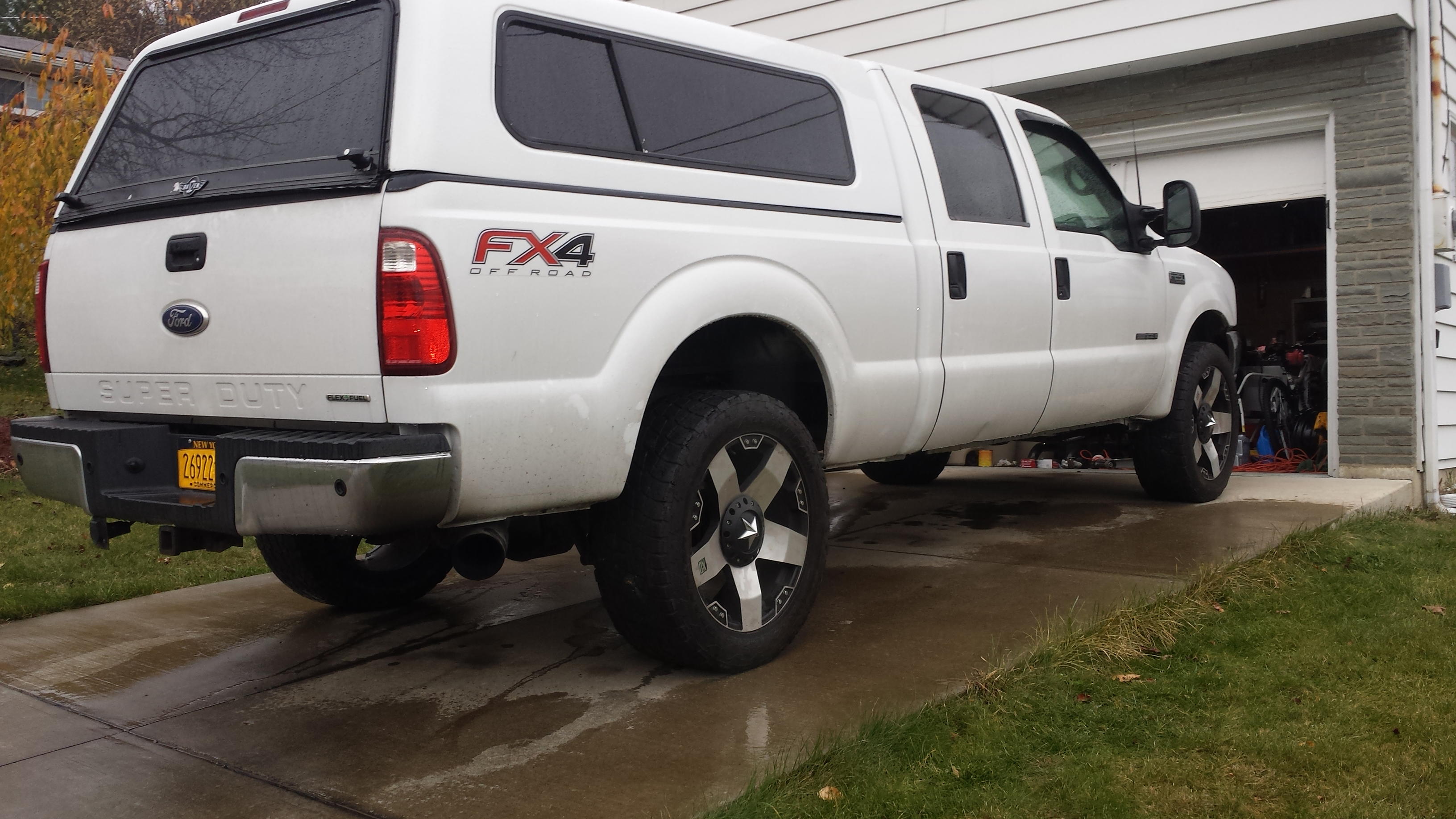

01 f250, leveled on 20x10 weld dakars -25 offset i believe with 35x12.50r20 trail grapplers. Very Slight rub at full lock on passenger side leaf.

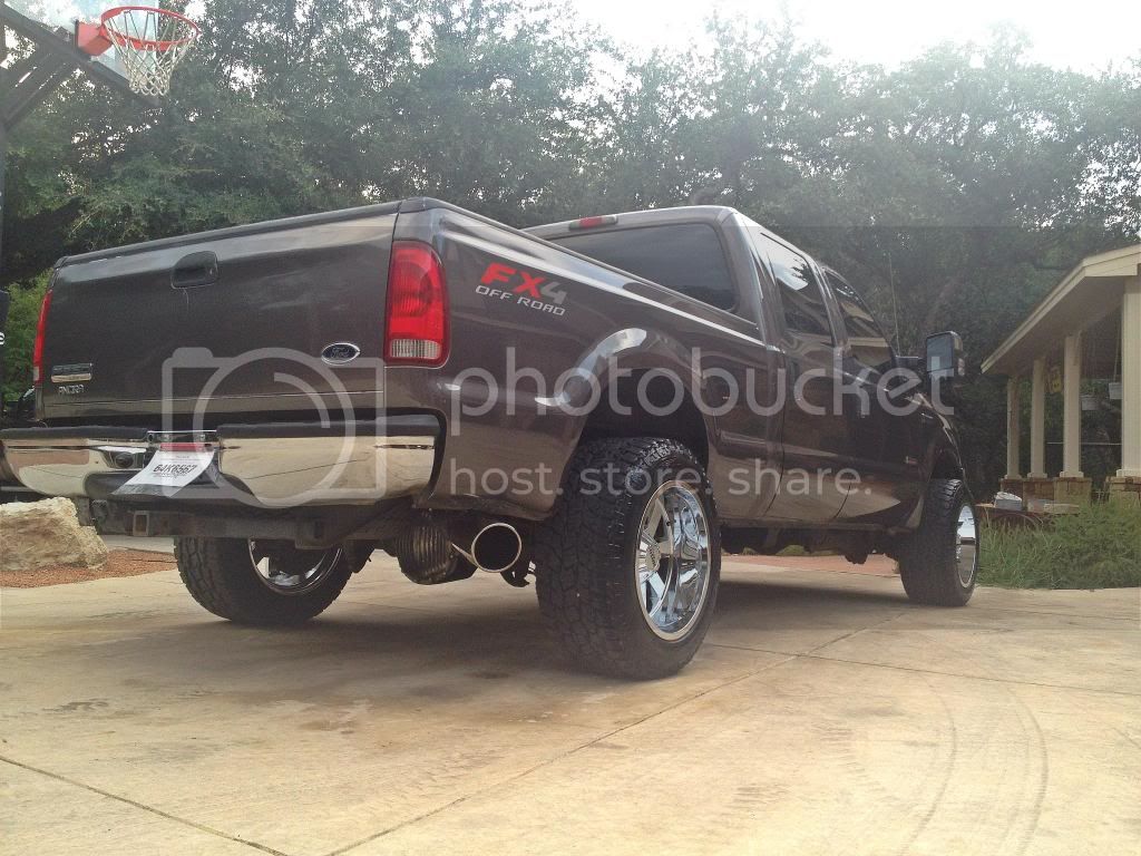

Wheels are moto metal 962 in a 20x12 it looks. An like a 305/50/20 nitto terra grappler. Truck looks beautiful with that setup.
That's what I was thinking, thanks! I just picked up a charcoal beige metallic 06 and am thinking about doing chrome since it looks so good on this color. Trying to decide between these moto metal or hostages. Might try a 305/55/20 duratrac too
