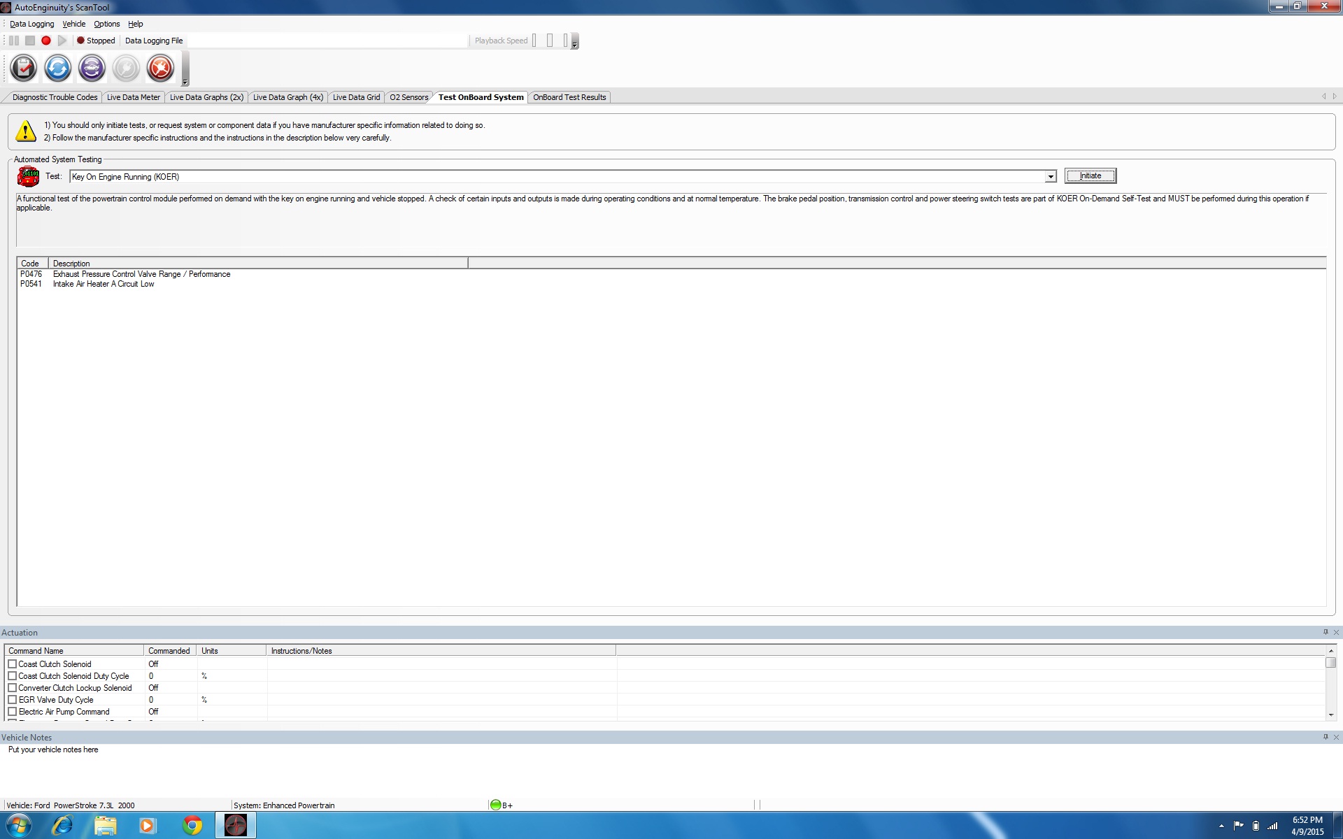

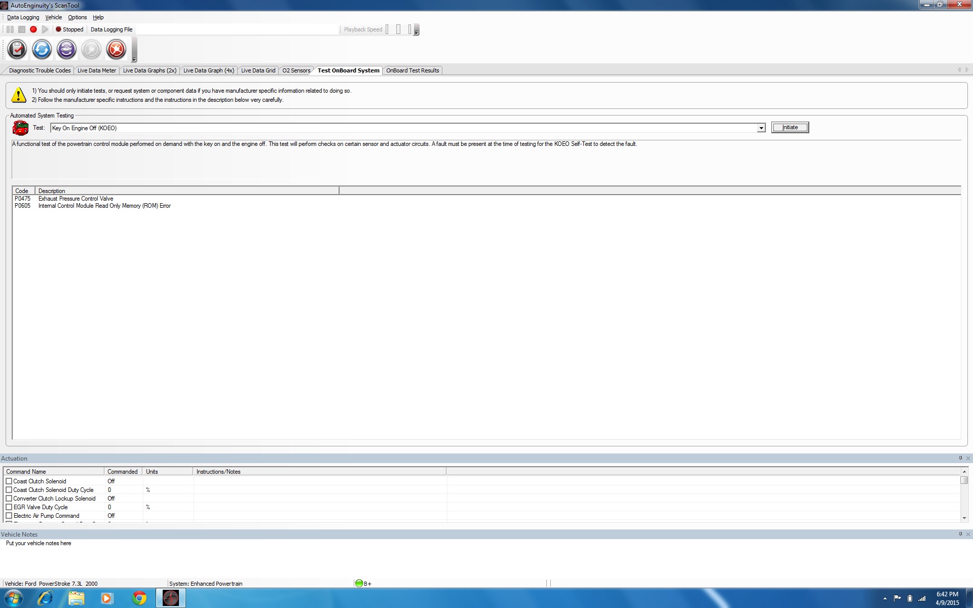

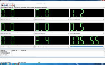

Here's some screen shots I took from AE last night.
