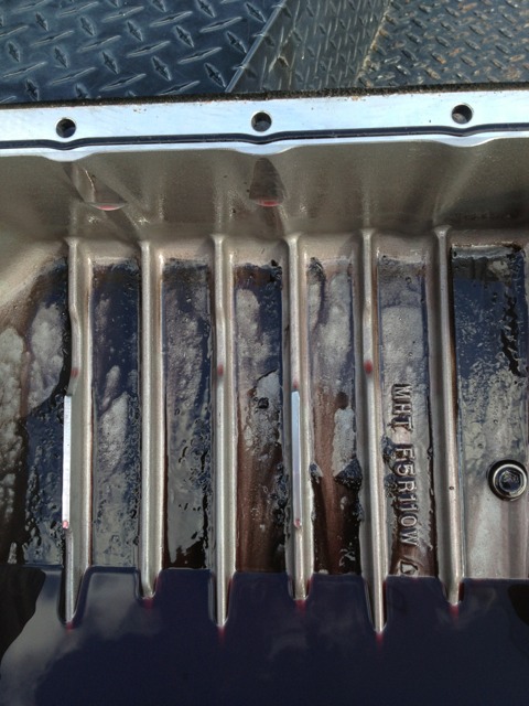

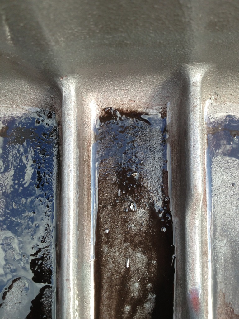

Officially have no 5th gear. Trans is hurt too bad to shift past 4th. Gonna be a slow annoying drive to worlds.
Is it the clutch pack or the solenoid, might want to drop the pan and just see if the solenoid has trash in it. Are you getting any codes ?
He dropped the pan, there's debris everywhere and the solenoid is jammed. Yes he is getting codes. He posted all of this. He tried an oil change too. Clutch pack is burnt and failed or the torque said F*** you.
