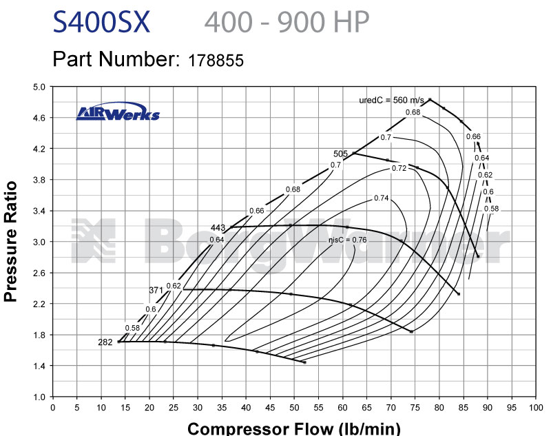

I guess if it was up to me, and it was to be a DD, I am not sure why you would go with a 467 over a 369, especially one with a gated set of pipes. I realized the 467 is a proven setup, but the 369 compressor out flows the 467, should be easier to spool, and with a gate will let you keep hammering on top. Its already proven how well the 74mm turbine side of the s300sxe's are working.
369
467

With the 366sxe, and a 1.0 housing it's 1:1 up to 40 psi. With my 238/100s back pressure peaked at ~65 psi. I posted videos before in a few threads. If you gated the pipes you shouldn't have any back pressure issues.

There's a big difference between 238/100's and 300/200's. s369sxe all the way with 100%'s.
I spin Nitto 420's in mild tunes with 350/200's and an s468 with a 1.10 housing, it's not a laggy setup.

200% nozzles should make things spool faster, I agree. But at that point, why wouldn't you want a turbo that spools faster and flows more air ? Please enlighten me.
A 369 Should out perform a 468 on both sides. And if you spent the extra money on the gated pipes, you wouldn't ever have to worry about back pressure on the big end. Plus you'd have more air then the 468 available too.
The only benefit in my mind of the 468 would be the larger shaft diameter. But I haven't seen or heard of anyone blowing apart a s300sxe yet.
You may not have any issues spooling a 468 or towing with it, but if there's a turbo that spools faster (and should be even faster yet with your nozzles) and flows more air, why on earth wouldn't you ?
The OP can do what he wants. I just hate bad logic.
