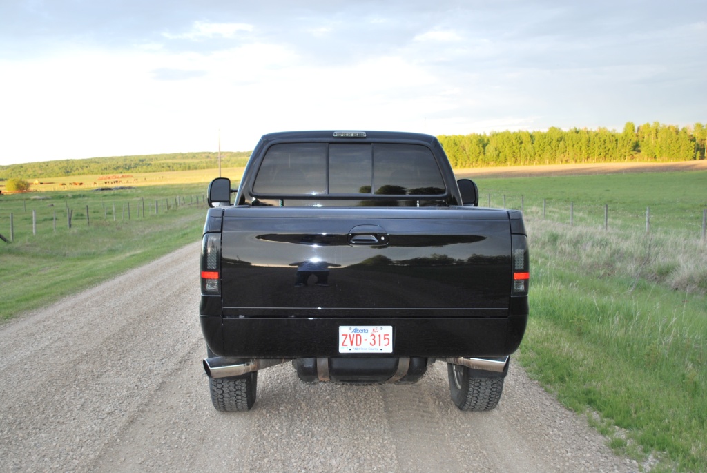

Here's a shot of a shorty 4X4 with an excursion tank.
After talking with the owner of this truck I decided this was not the best option as the cross member needs extensive mods to get it to fit. I believe it would be much easier to entirely remove the cross member and build a new one that will accommodate the tank without sacrificing strength.
The pic didn't show up for some reason on my phone. I don't really want to lose my spare tire area. I have been calling around and I found a couple f150 tanks but it looks like they are about 4" too long as well.
