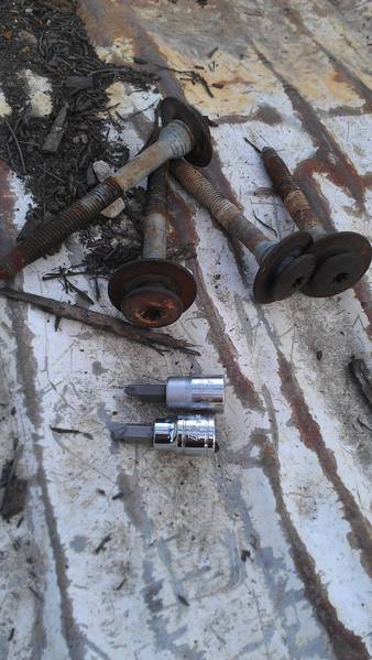

The bed bolts? I had one that I couldn't get off with an impact. I cut the head off of it. Not worth fighting.
I was thinking about doing that too, these are all pretty rusted, I haven't looked into pricing New ones. Are they mail order or can I pick them up at orieleys/auto zone? This guy also put a goose neck on this truck, he welded the platform directly to the frame cut a hole for the bed bolted the top plate onto the platform (it overlaps the bed hole for a cleaner look) and then spot welded the bolts onto the platform. I wish I had found a cleaner truck lol. This guy was Hell on this truck.

Well I bought a welder and some new blades for the sawzall, just gotta find the time to fix my parking brake, brake lights and turn signals so I can get this truck inspected. I replaced the flasher relay in the dash and the turn signals still don't work, I think it may be the mfs acting up, the hazard lights work but not the turn signals, I will try and tear into it today and maybe get it working. Jmart was right, I got 4/6 of the bed bolts out with an impact and some patience with liberal use of the penetrating spray, but I had to cut the two bolts at the front of the bed. I broke 4 torx bits trying to get them out, I couldn't track down a parts store that had an impact rated torx bit.
