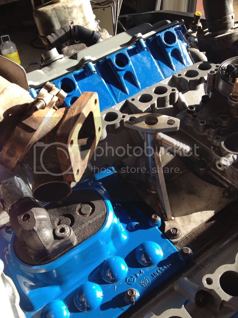

Little update.
Got the manifold finished up finally. Went with blue, gray was too much with the valve covers and heads being gray.
Starting piping this weekend, I finally have some time, and the 62 should be here this week, FI had been backed up, machining for the housing took forever.
Injectors are almost finished up, waiting on machining. Took UPS a month to get Shawn my sticks :fustrate:

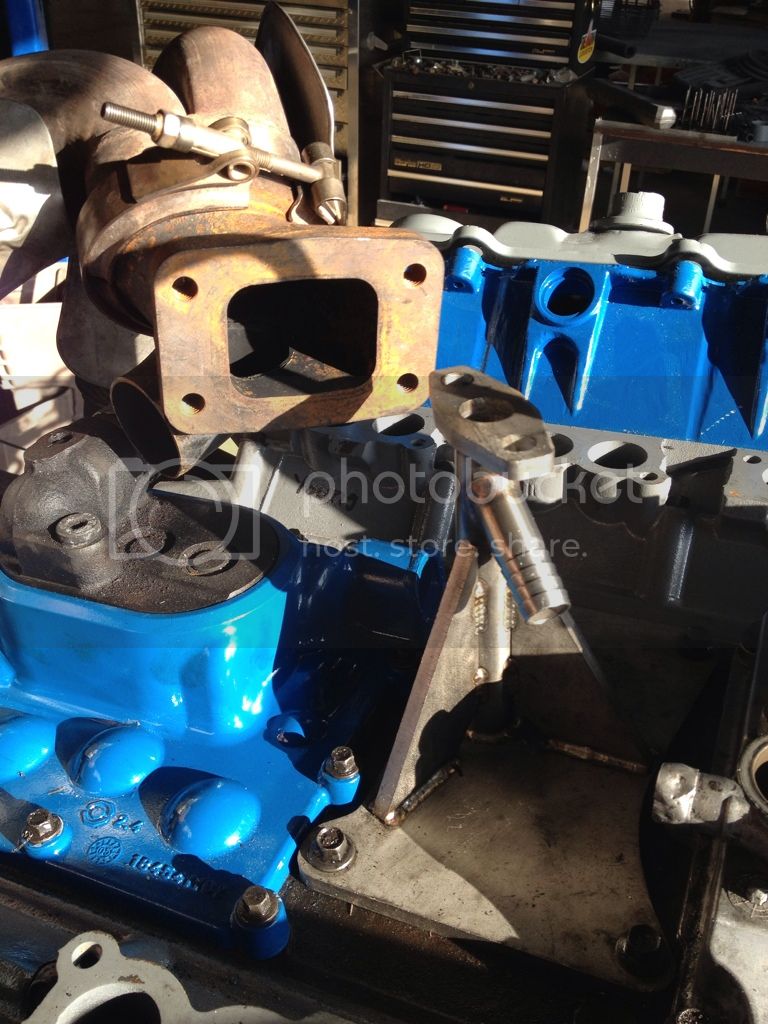

Does anyone have any experience with using a t3 BD collector with a TN pedestal? Just mocked up for now until the charger gets here, not sure if it'll work. Can't remember my old non vgt setup.

Dont think it will work, Need the BD stuff. I need to look for the part numbers, I have them somewhere. My buddy has the stuff you need (i ordered it for him) but I think someone already called dibs.

Damn, it didn't look promising when I looked at it. Good thing I got a bunch of 2" stainless and a t3 flange.

Is that BD adapter hiding a wastegate connection Morgan?
Yup. If it will work, that's where I'm plumbing my gate from.
If not, going to make the upper section of the up pipes from scratch. Into a 2-1 collector, forming into a t3 flange. Ill need ideas on where to plumb the gate in if I go that route.
