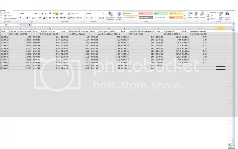

I'm bettin MAP if fuel pressure is good. Especially the way Matt tunes.
Replace the hose from the intake to the sensor and see if that does anything for you, since you've tried two MAP sensors.
Then take a look at the MAP pigtail.
