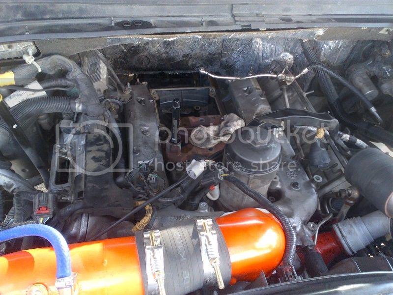

Turbos are off, down pipe is off, wg is off, up pipes are being unbolted. He's movin'

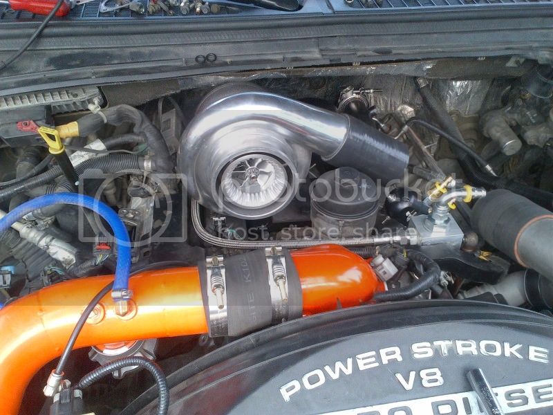

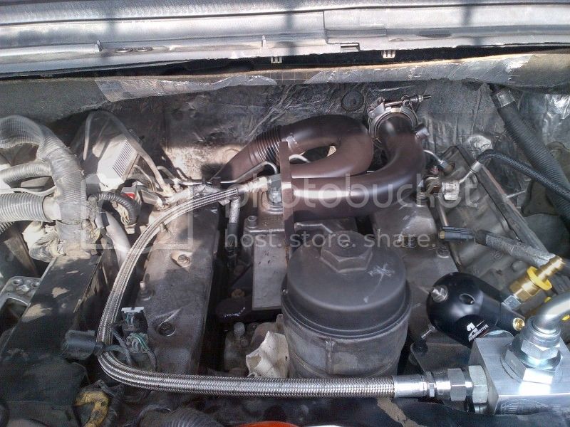

I wanted to delete it but after I deleted mine I started getting really high fuel temps and got some surging. I unplugged the fuel temp sensor things were good but the wrench light is on the dash now. So we're gonna leave the fuel cooler in for now and once I get my stealth cooler setup I'll send one to Pog. It's too bad cause it sure cleans things up with it gone.Sorry if I missed it but are you deleting the fuel cooler?
