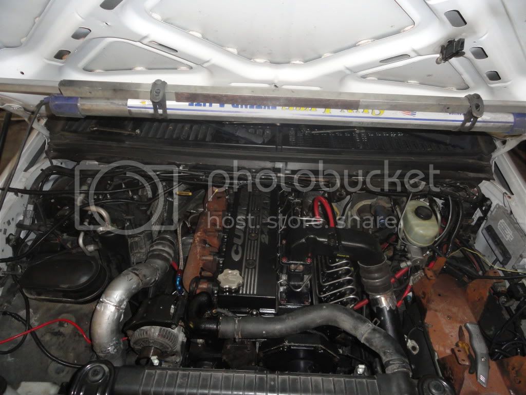

looks good Matt, for the P/N safety I used the P/N wire (ground when in these positions) off the trans harness and ran it to a relay for the starter circuit

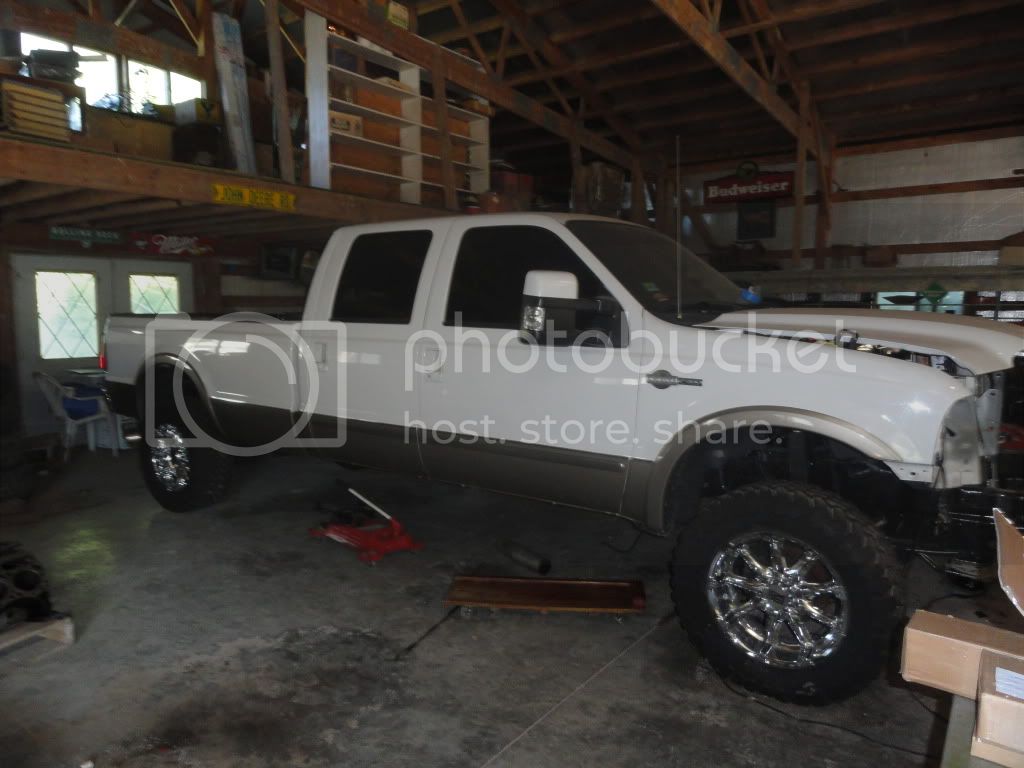

The mirror caps really add to it! Now it just needs some cab lights and you will be good to go.
