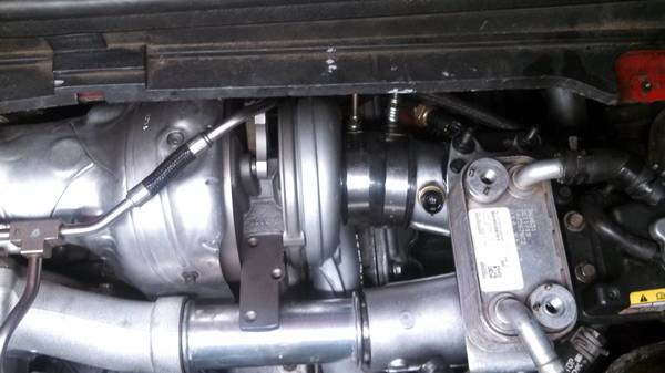

I was really loving the 76/59 combo that's been on for a bit. The jury is out until I hit the rollers on this combo, but this VGT is not too much bigger than the 59. It does seem a bit easier to peg the factory boost sensor than with the 59, but can't say for sure at this point exactly how it compares. Not counting the setup currently on the truck, I'd say the 76/59 billet with 60 hp nozzles has been my favorite. There's not a big drop in power over the 110 hp nozzles, but EGT's were noticably less, and heavy throttle smoke output wasn't where it is with these injectors. Before, I could drive around like an idiot, flooring it regularly, and smoke was minimal. Now, that can't happen without ticking off the people to my right. There was also zero exhaust haze at idle before. Now I have a little. It might be able to be tuned out, but as of now, it's not, and gets a little annoying.
