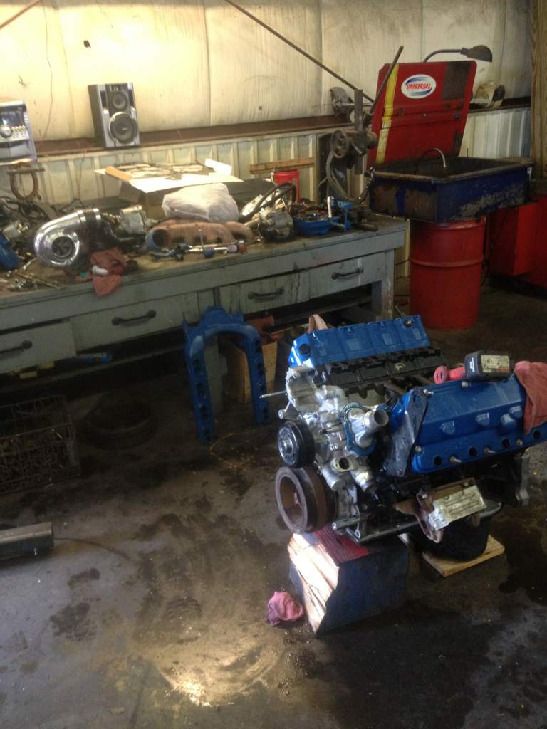

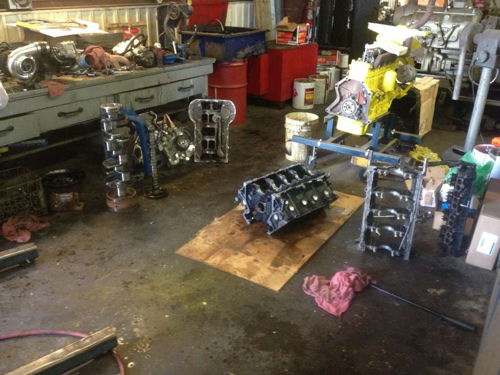

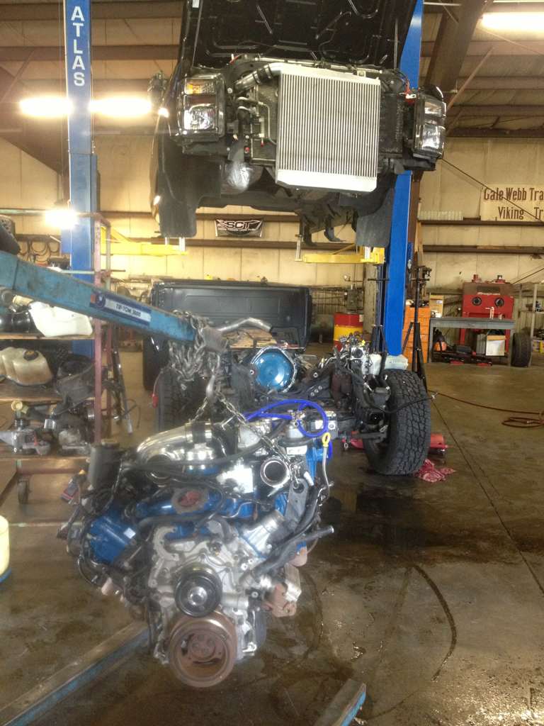

I'll order up all the needed gaskets and what not from ford tomorrow and see what all they have in stock. Get everything washed up and Probably start going back together with it Wednesday
