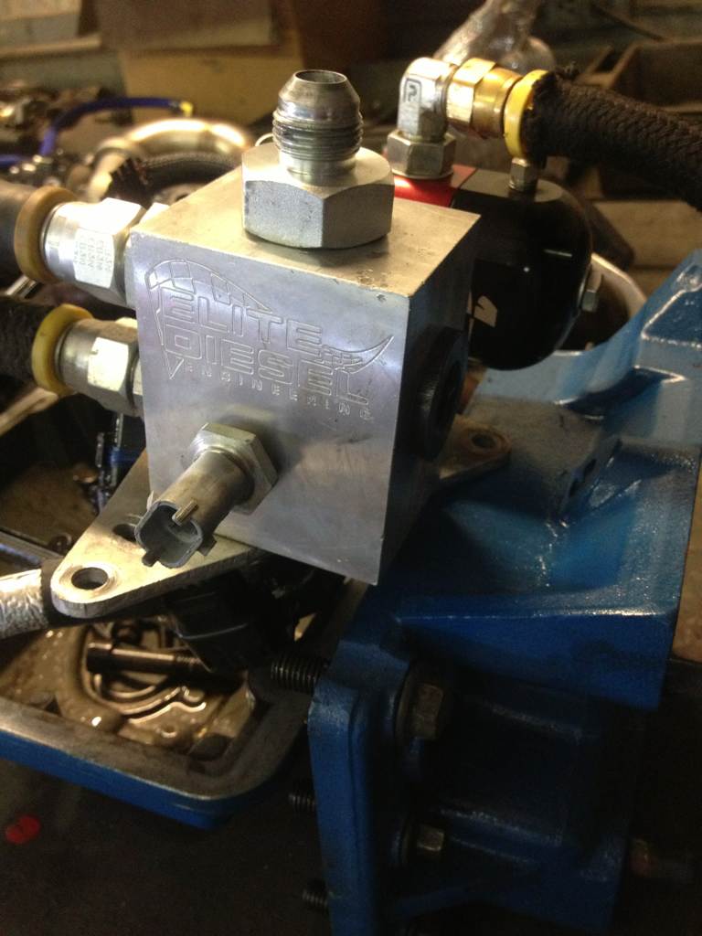

Here ya go Dustin
Dzchey21
11,784
wyoming
Turbine is too small
Plus I'm finding that you really need to be tying into both up pipes if you are doing a high volume of wastegating to the atmo (not in this case)
