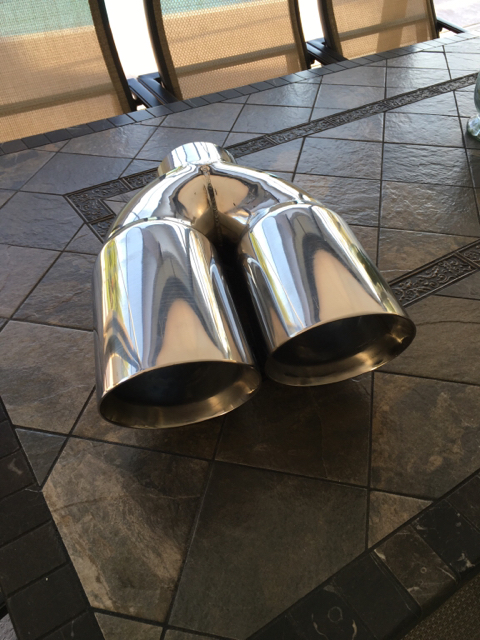

Finally. My stock Platinum replacement Tip. A little more polishing and time for the install.
