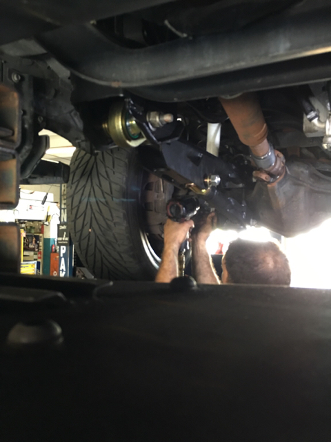

Front complete. Now it's time to cut the new 5600 coils and install.

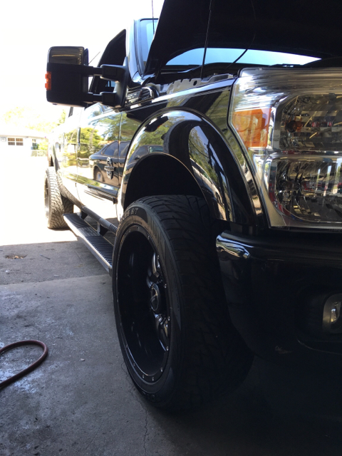

Thanks everyone. Drove around town then on the Turnpike for 41 miles. It's all about the handling and the ride for me. After having so many lifted trucks I didn't want anything to do with a lift. With advice from Jared and Mike and also helps with the other builds we have done I figured this is the best for my usage. I have the shock towers and will be going Coil Overs but that's for next year. For now we ordered shorter King Bypass shocks from Mike and a Hellwig rear stabilizer bar and that will finish us till then.
The ride is amazing and the truck sticks like glue to the road just like I wanted it to. At 90 mph it handles like a race car is the best way to describe it. It corners great and we really leaned on it hard thru a bunch of back road turns. Need the rear bar for sure. If my Trans was in better shape it would have been perfect. Highly recommend this setup instead of a lift. The shocks will make it even better next weekend.

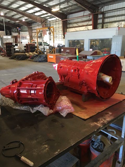

Still have not run her at the track since the motor build. Now that the suspension is almost done the last piece is the Trans which I should have shortly. My only regret is I didn't do a -12 offset with the 12 wide wheels. At the time they were impossible to find. In still thinking of painting the factor fender flares and installing them on the Platinum color match of coarse. Like your opinions on that. Reason being to protect the side of the truck but it might look really weird. Let me know. Dan

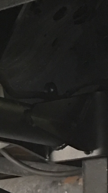

Do you have any sense that the ouo 3 link allows any more travel before the axle hits the frame?
I'm 2" lower, and even with very stiff springs and flat bump stops, I get frame/axle interference on certain roads.
dseitler
Feb 2, 2014
812
Royal Palm Beach, FL
Are you sure it's not your shocks that are bottoming out? You might have changed them already but I had to purchase shorter shocks.
There is a welded on eye for straps on the top of the top link. That would hit the frame first. Look at the bottom of the frame where the strap bolt eyelet is on the driver side and see if it is marking the frame. If not its your shocks.

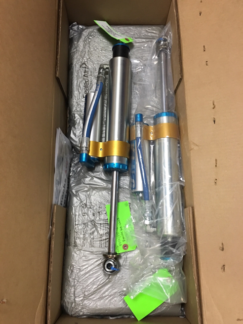

Trans install should be finished on Friday late afternoon but while we had a few min this morning we installed our new presents from Mike @ No Limit! Thanks Mike I can't believe the difference these shocks made and you nailed the length perfectly. No more bottoming out. Perfect!
