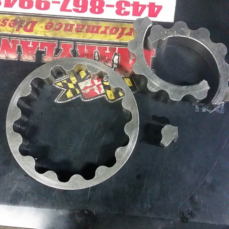

Their triple turbo 6.7 race truck. They cracked the block iircc on the first built motor and the second blew up like right away because of a oil pump failure. At least that's what i read.

IIRC it didnt actually crack the block. I think it broke a piston skirt and that trashed the cylinder wall. Initial thought was cracked block. Then again who knows, the story's changed a couple times based off of hear-say. Lol
well , my built motor is smoked , and its not an oil pump issue.

Did mpd ever say why their shop truck ate its motor?
This, and it happened halfway through a Dyno pull so probably not the best time for that to blow apart lol. Is from what I heard...
Edit: and they had a 2015 block (pretty sure from the test truck) with a hole in the side of it so defintely have had some unfortunate luck of going through motors. Just the name of the game I guess! Lol
