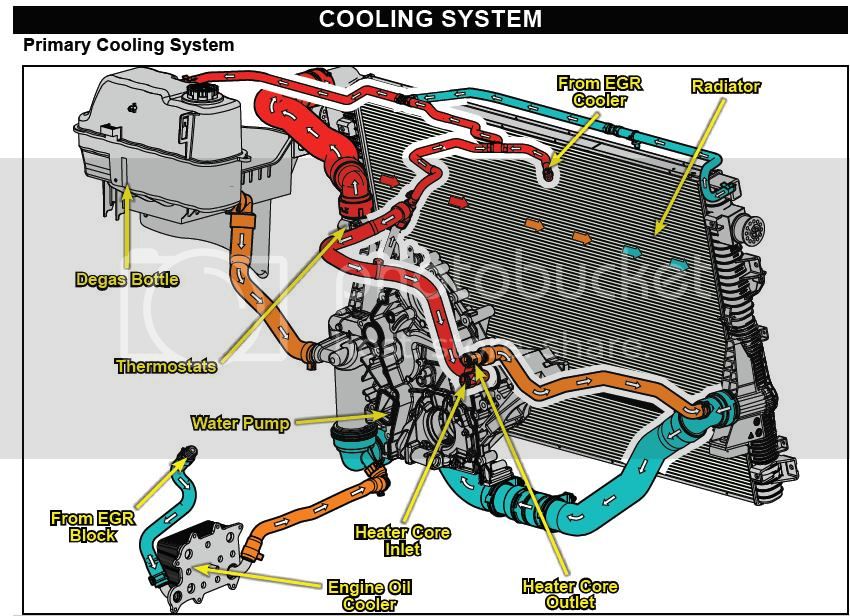

By removing the oil cooler strain on the primary system, and likely going to an aux cooler for the tranny, the engine and charge air cooler will have much better cooling priority...
Anyone know of an aftermarket secondary rad?
WHY NOT
Jun 21, 2011
3,912
Carlyle IL
Thanks for the pic dan. So the coolant from the egr block then goes to the oil cooler. I wonder how that affects on a blocked off egr passage compared to one like absolute or no limits plates that let the coolant flow through?
