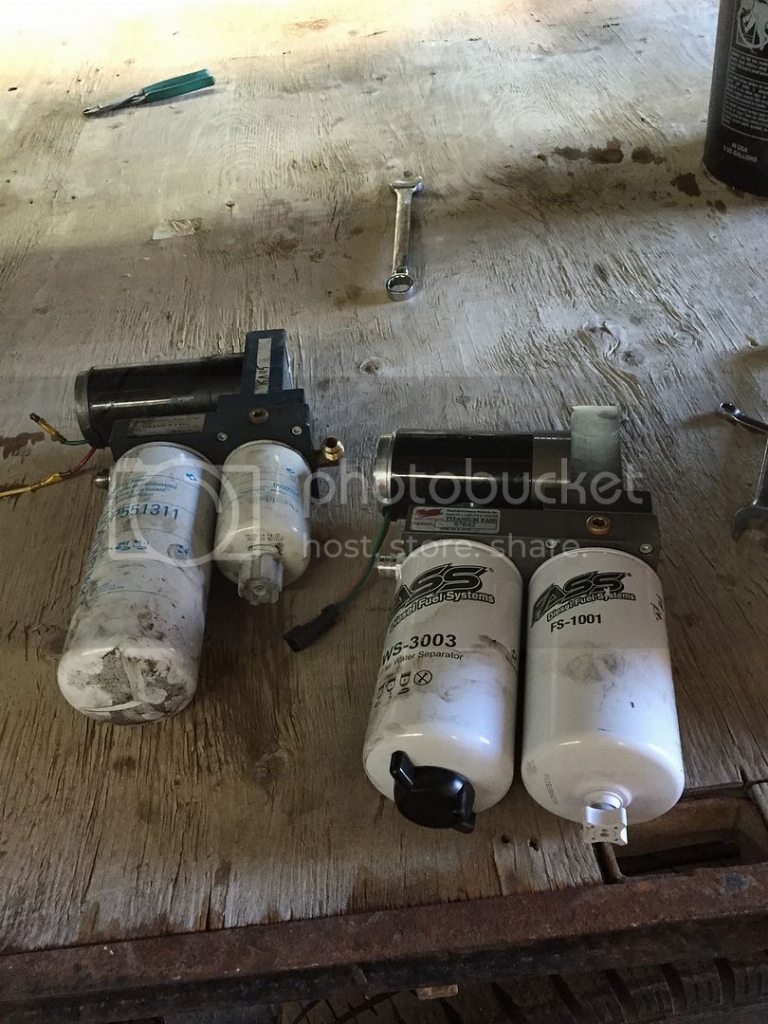

Fass pump is off being shipped back to fass, and see what happens there... Hoping for a warranty repair... In the main time I picked up another fass pump because it's the fastest cheapest easiest way to get the truck back on the road, until I can afford a h&s low pressure system

That makes the decision for me! Hey is it a fairly loud pump? Can the pump be heard over the exhaust note?

cant hear it at all. its not like a fass.

My goodness that fass is annoying
My buddy has a 220 gph on his cummins running lower pressure and the pump is nice and quiet..
Mine at 55 psi could be heard on the expressway in my truck with a non vgt turbo at 2500 rpm with a stack behind my head... The fass pumps just can't handle the pressures for whatever reason.
Yeah this is a thing... It defiantly takes away from the grumble out the exhaust!!!

My walbro pumps are nice and quiet, Only time I can hear them is key on engine off. Believe my buddy runs higher pressure on his 5.9 and they are still very quiet, he wouldn't run them if they weren't. GSL392

Just a little update, I got the new fass on, back up and running, inlet to the pump with the new pump (grey instead of blue) is 5/8 hose instead of the old half inch, as well as fuel water separator is a significantly bigger filter... Which would be on the inlet side of the pump... I wonder if the old pump was cavitating causing the excessive noise. This one is dead quiet, cannot hear it above the engine... So that's how that went
