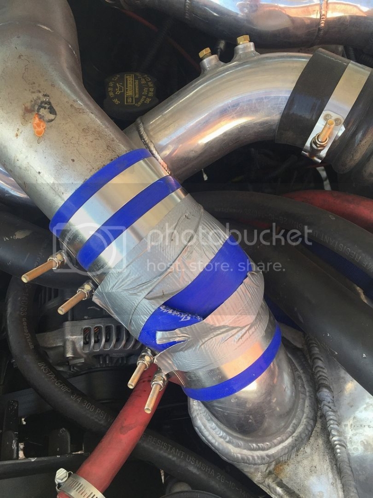

This boot finally blew up, so put another one on till I decide on how I'm going to get my piping reworked..

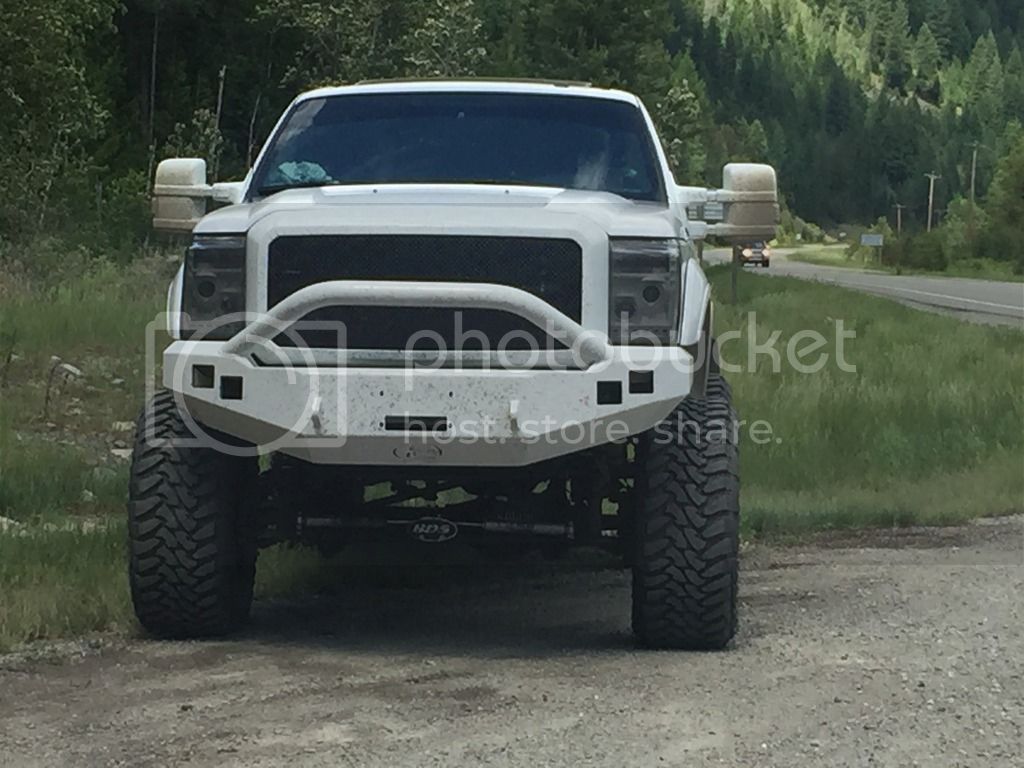

so were those donuts on the new 40's? LOL Truck's looking good man. I'm excited to see how you have the piping re-worked. Also wondering about wheel width and back spacing. Can you put up a shot from the front so I can see how far out the tires hang? Thanks :D

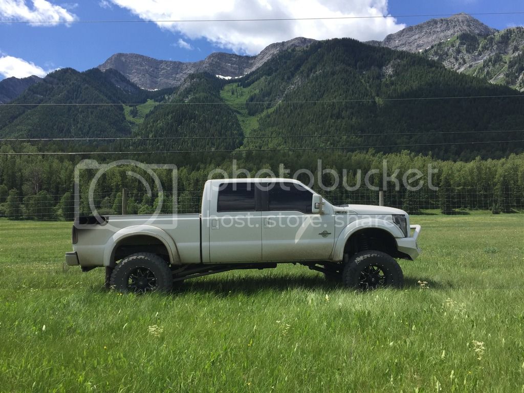

And they are 40x15.5 Toyos on 22x14 wide -76 offset... They are pretty proportionate I think

So yeah, Ive been tossing around a few ideas with the piping/ intercooler idea, no definite plans yet, but I defiantly have some hair brain thoughts and I'm sure I'll see a lot of criticism nomatter what route I go, one thing for sure is the coolant hose on my tco pipe won't last long and the air to water isn't the most effective way to go (secondary cooling system gets heat soaked fairly quickly) after my doughnut session the truck was spitting coolant quite aggressively out of the secondary resivoir. Before I make any changes I'm going to invest in a charge air temp gauge to see where I'm at

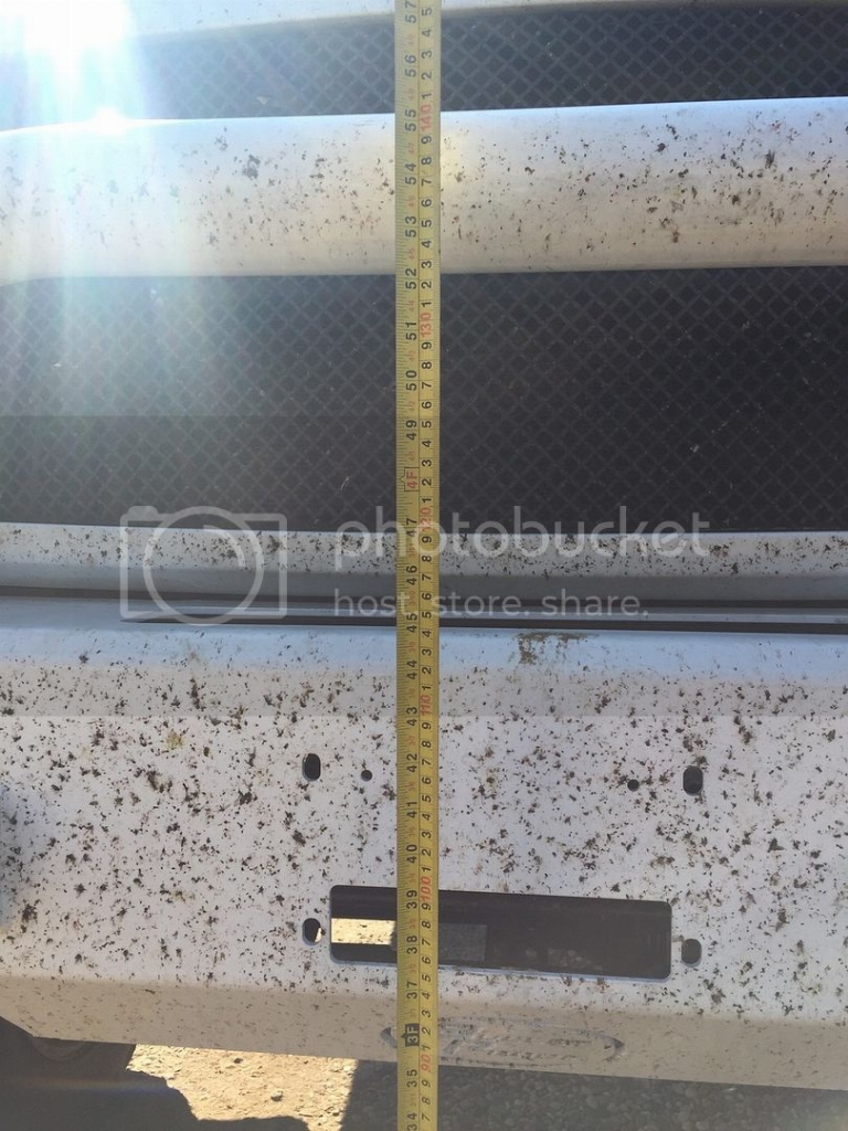

what your bumper height thinkin about goin 40s thanks
I'll have a tape measure available in the morning, sorry for the delay
