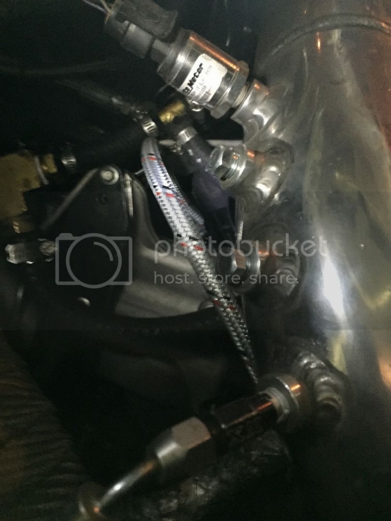

Trucks back up in Fort Mac with me now, new fass pump, had my hp line from the cp3 to rail crack on me so I used industrial injections "dual feed line" (Flexable hp line) to solve that issue... I'm just driving it all the time loving every min of it! Haha gotta take it easy as the trans is slipping in 5th and 6th so as long as I stay under 50% throttle in od it's fine, so in the somewhat near future it'll be getting a new trans... One of these days I'll set up a you tube acount so I can upload some fun videos

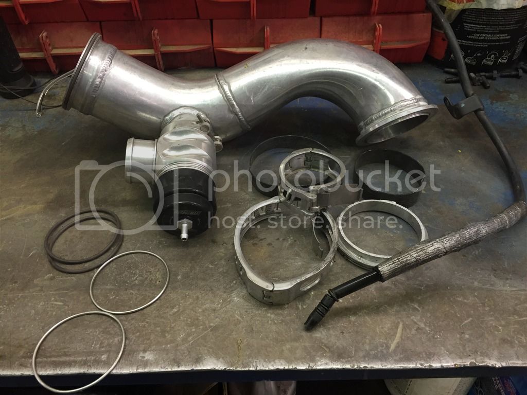

werd was there are issues with the turbo kit and it needed alot of love before they were gonna mess with it.
Yeah turbo kit is literally falling apart... So yeah... Have to make up my mind what's going to happen there.
care to go into any more details about this?
(fwiw not trying to stir $h!t or anything, just generally curious)

As great as those are, you gotta have a flex point where some stuff is mounted to the engine, other stuff to the core support, and more yet "mounted" direct to the frame. The boost braces vibrant offers can work really well to keep boots on when everything is designed properly.

I sheared a boost brace clean off when one of my boots blew off at 75psi lol....

:shrug: There are stronger alternatives. so for guys like you, I suppose industrial type brace would be the ticket. I've had good luck with them, but when I put them in, the only direction they would pull is out, not in some other direction. What ended working for you?

My piping eventually settled and I haven't had issues.
