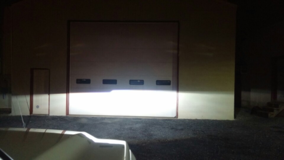

I hear ya, i started out with cheap hids, not bad but they blind people so i bought some Spyder brand projector headlights, well the light output SUCKED so i got Morimoto hids for them, still majorly sucked so i went ahead and ordered mini H1 projectors and retroquick brackets so the install was a snap! Once i got the lenses off that is, turns out the lights were sealed with permaseal instead of butyl and i ended up having to go to a professional installer were he fought them like crazy to get them apart. I put the projectors in amd resealed them myself. uploadfromtaptalk1434928438235.jpg

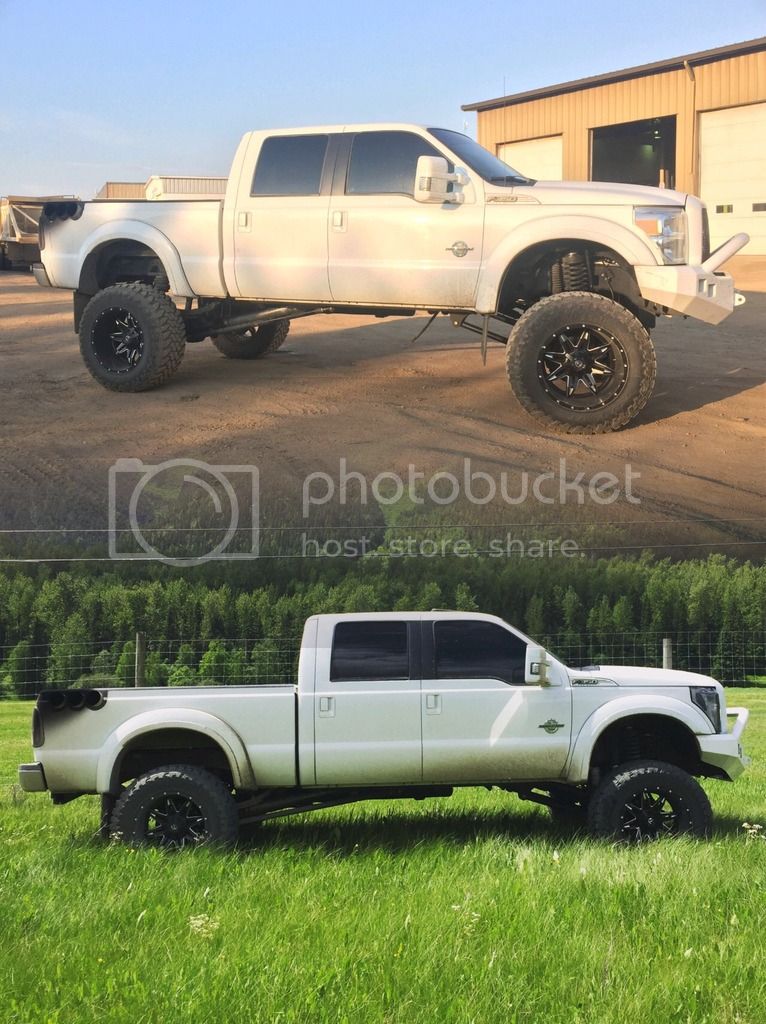

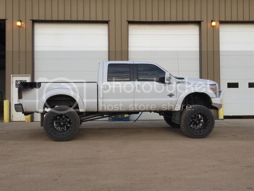

And ok so for the rake/ lean I put that 1 1/2 block in and it sits just where I want it... I fell like the picture hardly does it justtice where the 5"block was in... The back was way too high. So where it sits now, if I measure off of the rocker panel body line the back is lower 1/4" which isn't as gay as 10" lift in the front and stock in the back hahaha
Before:
After:
