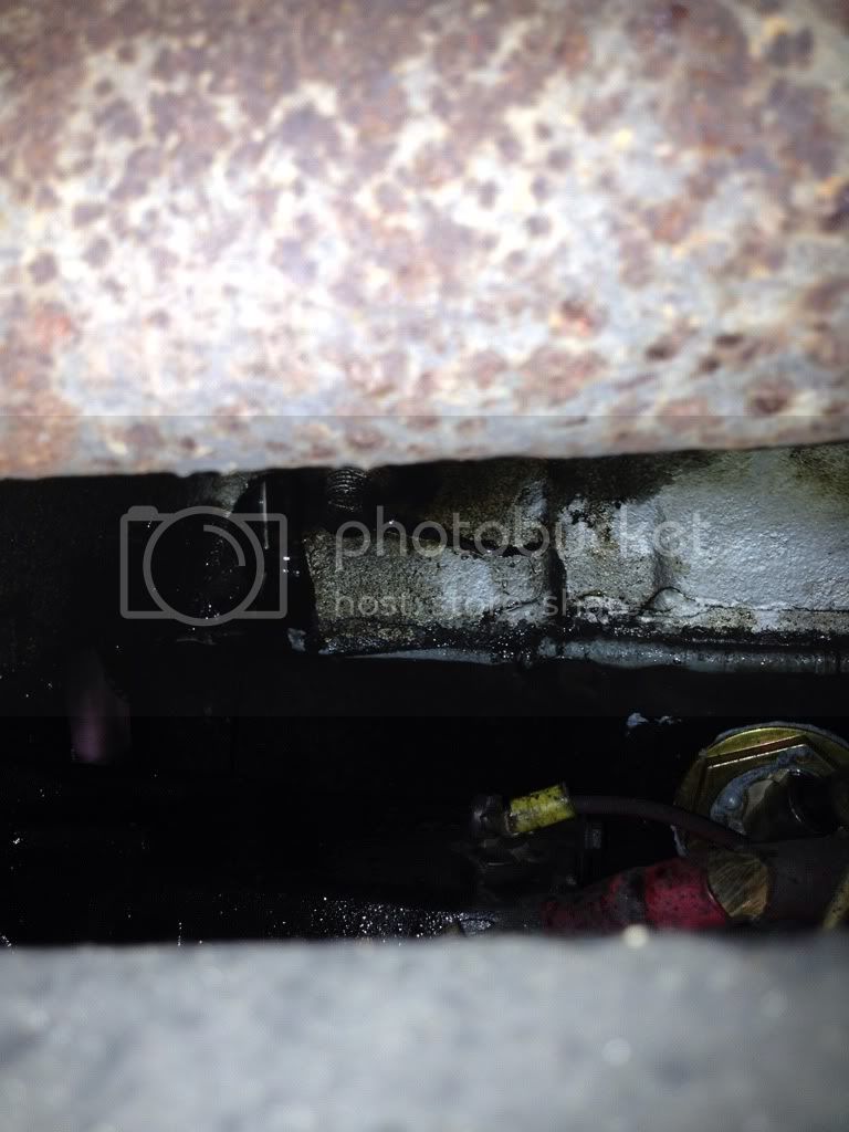

Looks like what you said about hydro fracture. But the rod let go at the same time.. So was It just the rod that went or did the hydro fracture cause the rod to go?

Im being.an ass Steve. Whether the rod busted that or it busted and let a rod go it appears there was a structural failure in and around the pan seat. Its pretty gruesome to look at. The fact its cracked all around the pan seat/rail is pretty telling.
I feel pretty bad for the op as he just got this truck going. Its a nice daily driver of a truck.
Well mads, if you hydro.fractured it then the block would have been moving around. Stress on the rod from movement and Boom. Its prett hard to doubt fracturing looking.at the broken glass appearance of the block right there.
Im being an ass too because I specifically stated in the original build thread to NOT do the pan job in frame for these very reasons and I was blown off like I was speaking klingon or something. I still feel bad for the OP because he really didn't know any better to believe what I had to say and this chit happened to him when he was having fun with his toy. Thats a confidence killer for most. Kudos for keeping after it!
Ohhhh, I remember. To be honest, first thing I thought of.when I saw this thread. I did one of these:eek:

So how do you hydro fracture a block and what do you do to avoid it?
Talks about it a little in this thread. Starts at post #77
http://powerstrokearmy.com/forums/showthread.php?t=18310
Basically its from getting residual silicone and/or the new pan sealant onto the pan bolts or into the pan bolt holes and then tightening up the bolts in sequence creating a mini hydraulic press effect in each bolt hole, if you will. The force can be enough to hairline fracture and even crack the block immediately. It's a chit deal

before everyone goes and blames some silicone for cracking the block, shouldn't Mad check to see if the rod broke first and shoved the block out? :shrug:

I must have missed what was funny about the block cracking from that exact scenario?? I never said it was the cause either, I'm just saying the picture doesn't look to good
