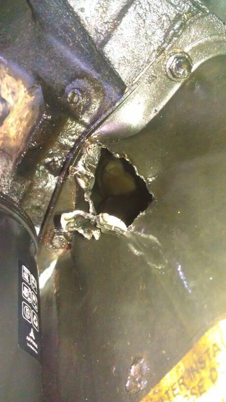

Sorry to derail the derail, ( good info tho)
by oil filter. Matching hole passenger side. No obvious holes I. the block tho
sent while looking at a hole in my block

Oh this I know.... Coolant wouldn't be leaking out the oil pan if it wasn't. I'm just disappointed to not see a huge hole.
Mine went the same way. Only a small hole about the size of a quarter knocked out of the block. The rest of it came out of the oil pan. I was wanting major carnage. LOL
