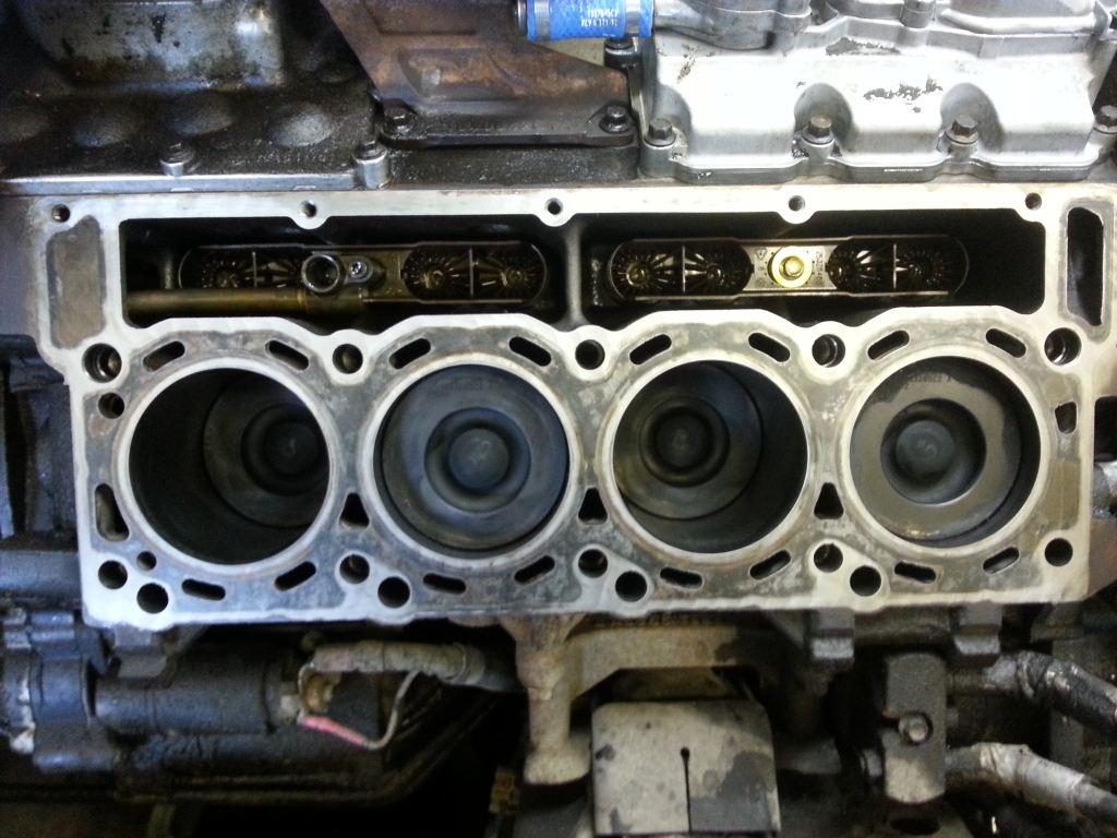

Here is a perfectly prepped deck ready for gasket. If you take these stains out the block surface will be untrue... takes about an hour and 4 razor blades...
IMO, 7.3 decks are nowhere near the amount of time it takes for a MLS style motor...
Thats exactly how it should look.:D

you want to know what the problem is with the guys that have 10,15,30,45 years experience in this business??? Their head swells... Cause I have had those guys tell me to just take a cookie wheel to the surface balls out and make the surface look shiny...
and like I said in all my prep posts... I cannot recommend a air powered tool to anyone, but I have used them in the past to my advantage... but now that I have tried the blade, nothing looks and feels that good...

hmm, I have used razor blades for decades,,,, didn't like not having control over the power tool,
