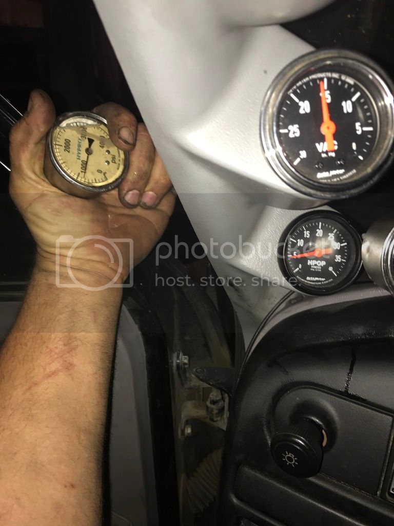

Did a little more work this evening. Got ground at the sensor and ground wire at pcm connector is grounded.
One thing that I can not understand is why is there a 400-500 psi difference between the actual psi and the reading the computer is seeing.
Look at the bottom gauge that is coming off the ICP sensor, it shows the same as my scangauge monitor. If the computer was seeing the actual psi as shown by my mechanical gauge I doubt it would throwing a code. Any ideas?
