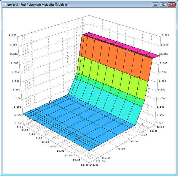

Let's get something out in the open here.....
After looking at many different tunes from many different tuners, I can honestly say that the majority (not all, but a vast majority) of them advance the timing above stock. Even tunes from those who are highly regarded and have stellar reputations on this very board.
With that said, I will not name names, and I will not post up someone else's intellectual property.
How much advance from each tuner is debated. Some only slightly, others a significant amount. And not everyone is going to agree on what is perfect, what is too much, and what is too little.
At the same time, out of all the tunes I have personally seen, none of them had absolutely outrageous timing. Even some older tunes.
However, I have seen tunes that had some significant timing advance, but at the same time some ridiculous amount of fueling. And that's the real problem. Timing by itself won't always break an engine. But couple some decent timing advance along with some massive overfueling, and now you're on the ragged edge.
So while all this debate is going on about timing tables, folks need to understand that it's only half the issue. Let's address the fueling too. And in regards to fueling, I'm not talking about old tunes either. I'm also talking about recent tunes.
Here, I'll start:
This is just one of many examples. The pic below is the stock fuel pulsewidth multiplier table. This table will multiply the calculated fuel injection pulsewidth based on ICP and engine oil temps. This map is designed to increase pulsewidth to compensate for oil temperatures, especially cold weather driving.

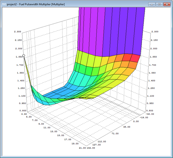

Now this is an example of a modified one. I simply created this table as a representation of some that I've seen from other tuners. Note that this is not someone else's exact map, but it's damn near close to quite a few out there:
Notice how high the pulsewidth multiplication goes. What's worse is that it's not basing the additional fueling on RPM's, but rather simply oil temps and ICP. So you could have low RPM's and higher ICP, and just be blindly dumping fuel in by the bucket-full. Now couple that along with some added timing, and you folks can start to get the picture.
It's no wonder that people data log their trucks and watch fuel injection pulsewidth at WOT go beyond 5 or even 6 milliseconds. And then they wonder why their truck smokes so much, has such a touchy throttle pedal, have extremely high EGT's, their ICP takes a nosedive, and their truck sounds like a rattle trap. Then when a rod is spit out..... it's done.
By the way, that pulsewidth multiplier table modified like that... is more common than some folks might think.

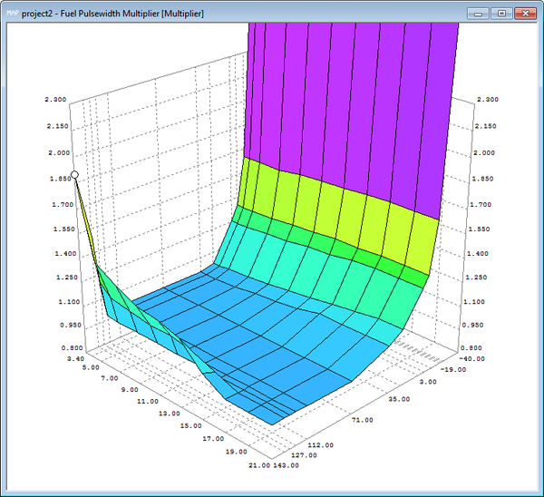

And for giggles, here's what I use on my truck:
