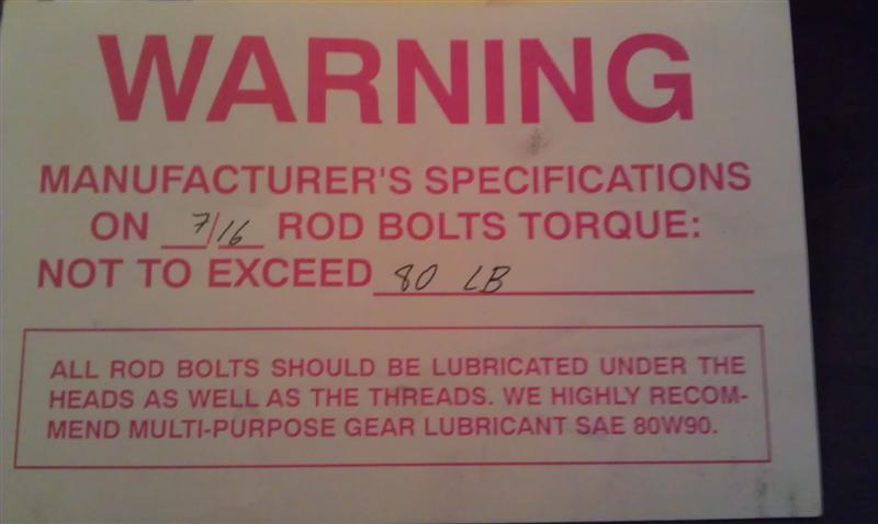

Cunningham uses what bolts you order Wayne. You can request ARP, h11's, custom age and many others as well. If his rods require 80-90w gear oil then use that. Just cause one person uses the same part and it says to use something different doesn't mean you should not follow the instructions for your parts.
Didn't know that. Thanks for clarifying for Ivan. Good info to consider anyway.

Ivan: Cunningham uses A-1 for bolts, and Elite's last batch of Cunningham rods came with the Detroit Diesel lube I listed above... something to keep in mind.
When I spoke to Jim, he was CRAZY about making sure I used only the 80W90 gear lube...
He even threw in another reminder:
